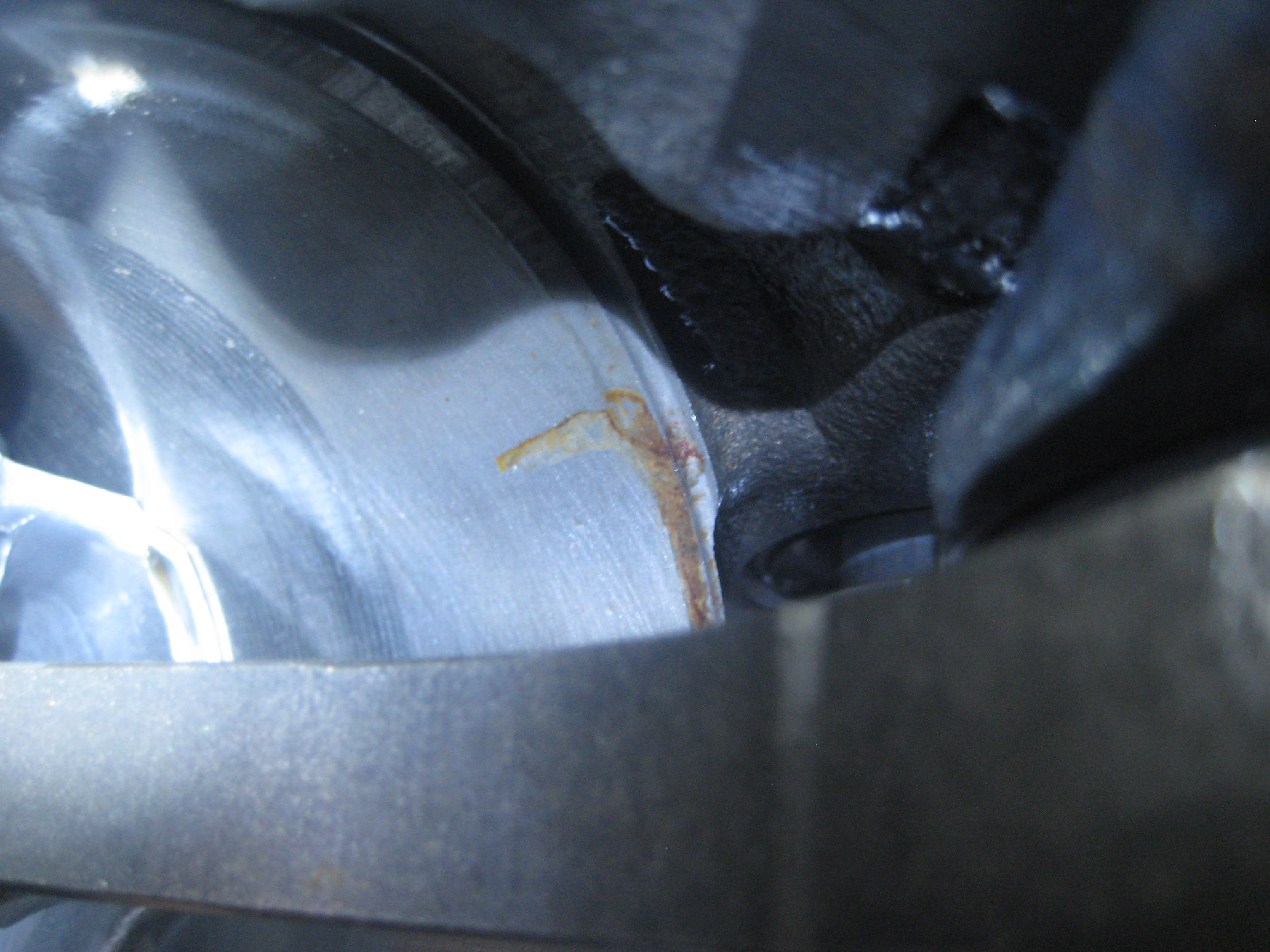

Add another to the list! Just pulled my pan last night with the engine still in truck and finally have an answer to this nightmare! I have spent the last 8 months chasing a small water leak. This all started shortly after the ARP studs were put in and torqued to 325. The funny thing is that at the time ARP stated to torque them 325 when they were installed last April. Now when you go to their website and they state 275. Anybody have any idea why they would have dropped this value by 50ft lbs.
2008 F450 62,000miles

I don't hotrod it around so this is very frustrating!http://powerstrokearmy.com/forums/images/smilies/wtf.gif

They dropped the final pass torque due to a change in lube.

I know this thread is a little old but You can add another to the list. I thought my front cover was my problem but not so lucky. I pressurized the cooling system and removed the drivers vc. 2nd stud from the back top was seeping coolant from the hole up the stud. I tried teflon paste with no luck.
I started with a reman block so holes were perfectly clean, installed the elite/a1 studs by the book. I have no way of knowing if the block was already like that when I got it or if the stud caused it. I am good friends with the Ford parts manager, he is gonna get me a new short block but it still sucks I have to change it all out again.
50ft-lbs seems like a lot based on just Lube change. I just got done installing my studs a few weeks ago in what has to be a Job 0(2006) motor and the instructions clearly read 275.
How soon after studding have these leaks shown up?
Have any 6.0 blocks had this problem? Is it possible that upping the bolt size for the 6.4 is not leaving enough steel to support the additional torque value of the bigger bolt?
