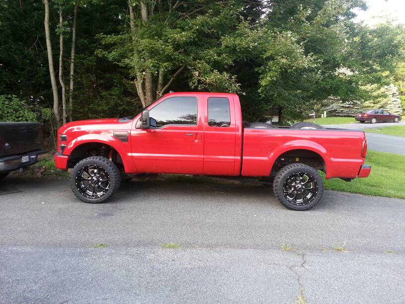

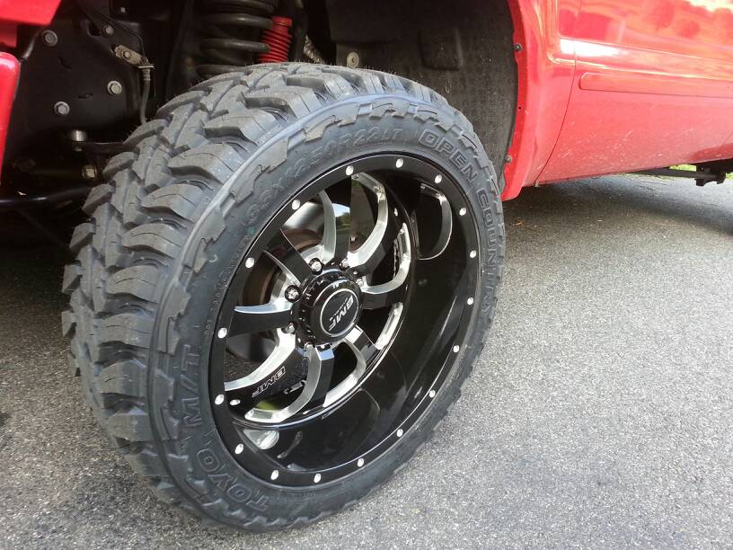

Couple updates....
Went ahead and got some 22s and 35s. And yesterday I picked it up from Mpd where I had some 30% nozzles. Now I haven't switched to erics low pw tune he wrote for the nozzles yet. But the truck drives SO much better. The added fuel makes a huge difference cruising in overdrive. It used to be cruising at 55mph trying to spool it uo a hill it would climb past 1000egts with ease, not to mention spool real well. I've driven over 100 miles and haven't touched 1000 degrees yet and that's with the 35s which didn't help at all. And that's even builsing mph going up hills before I was only maintaining speed. Eric said it will only get better with the new tune so we'll see. I only really got on it one time from a 70 roll and when the converter locks it pulls hard as *** but only maintaining 18k rail pressure but I def don't feel a loss in power. Ill have some numbers here soon, but either way they help tremendously with driveability.

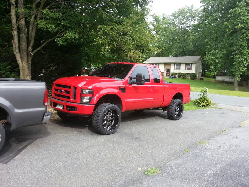

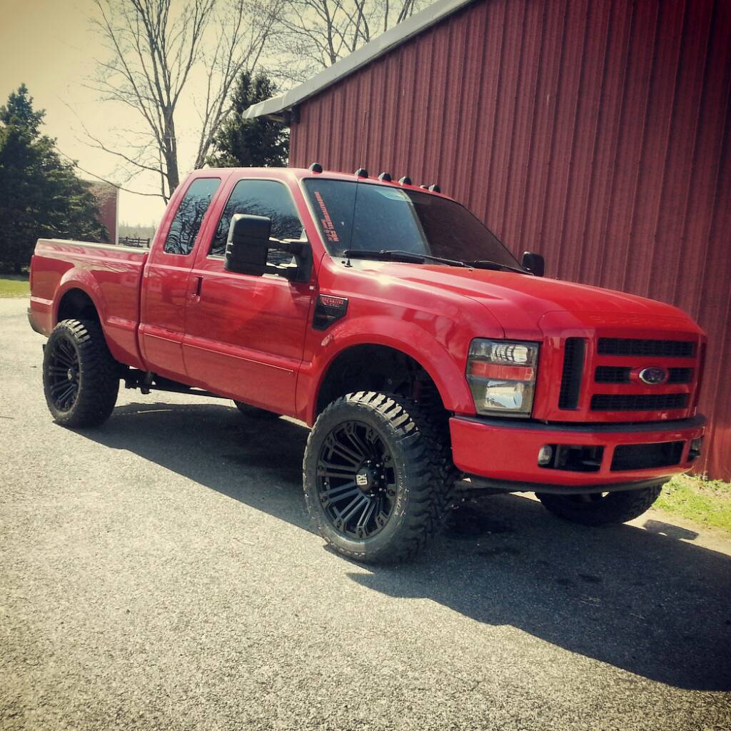

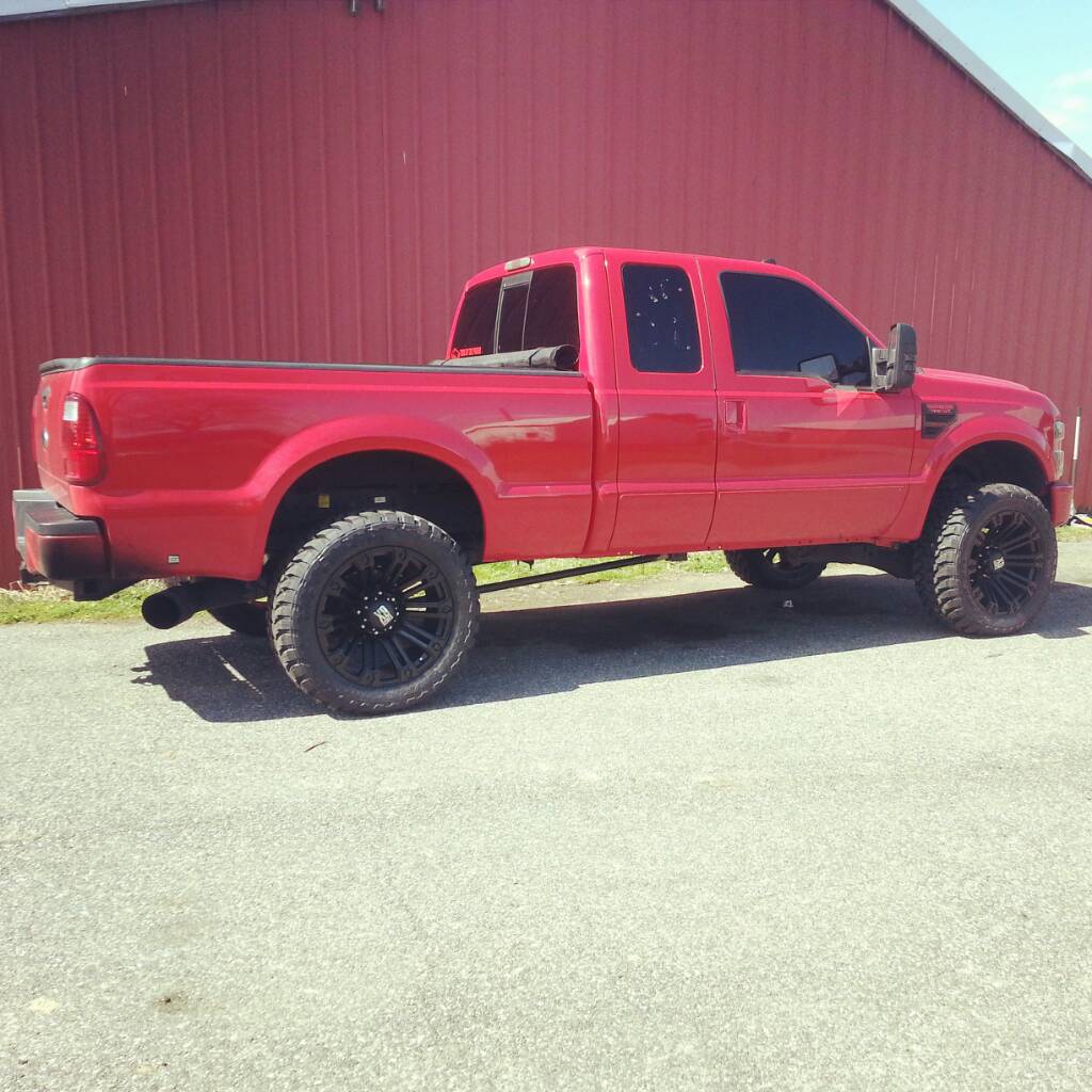

Couple more updates. I already went back down to a 33" tire the 35s sucked spooling the single. Kept the leveling kit but Couldn't sell just tires everyone wanted rims too so I got some 22x10.5 bmf novakanes as well :). Also I put an II hpfp in it along with 60% nozzles and the truck drives awesome. Amazing how much added fuel helps this thing normal driving. Also between wheels and tires swap I had stockers on there and took her to the track. First pass I tried leaving at 2000 rpms and it took a little to spool and ran 11.69 @ 118 with a 1.75 60'. Second pass left at 2500rpms. NO lag. 1.58 60', 7.27 1/8 mile, and 11.47 @ 116 in the 1/4. Thing was getting it!! Ill post the video I took for a member to compare to his s480 just to show boost when normal driving.

Mpoage
1,017
OKC, OK
That's one of the best looking extended cab 6.4's I've ever seen. Those are some pretty damn good times as well. I'm surprised you pulled that low of a 60ft on stock tires.
