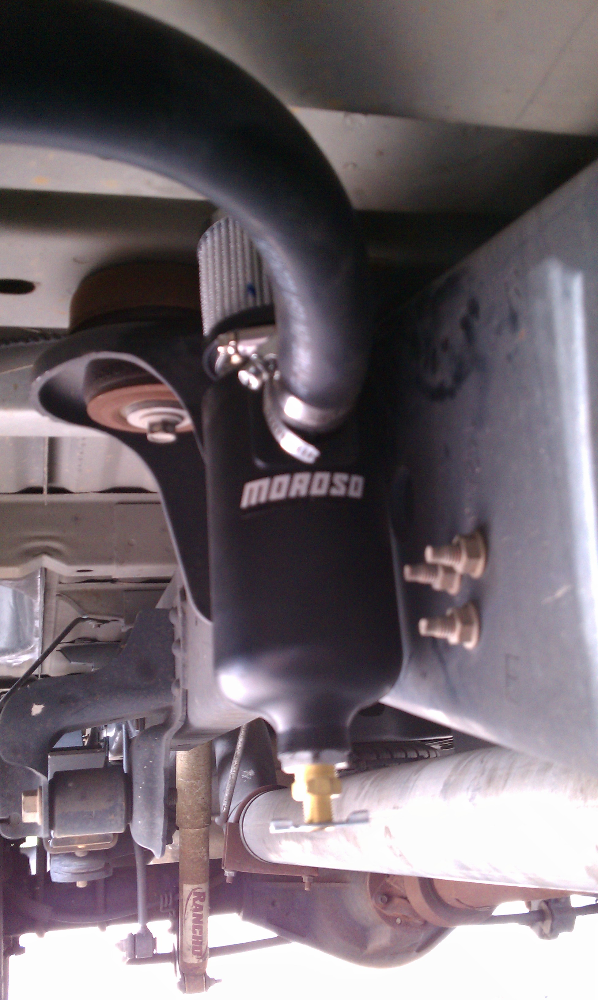

i ran mine down under the pass side into a moroso catch can

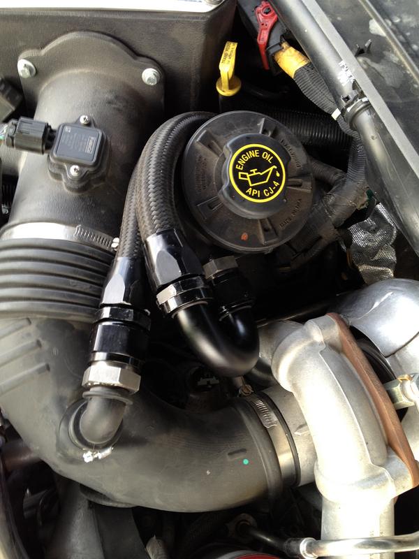

I've been running a Darkhorse Diesel ccv, into the exhaust, for several months. No issues so far and no oil mist in the charge air system.

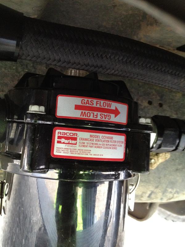

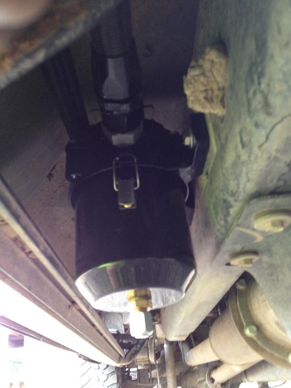

Heres how I did mine with a Parker CCV filter have had no problems with it at all check the filter every other oil change and i have never had more then about 1/2 oz of oil in it
