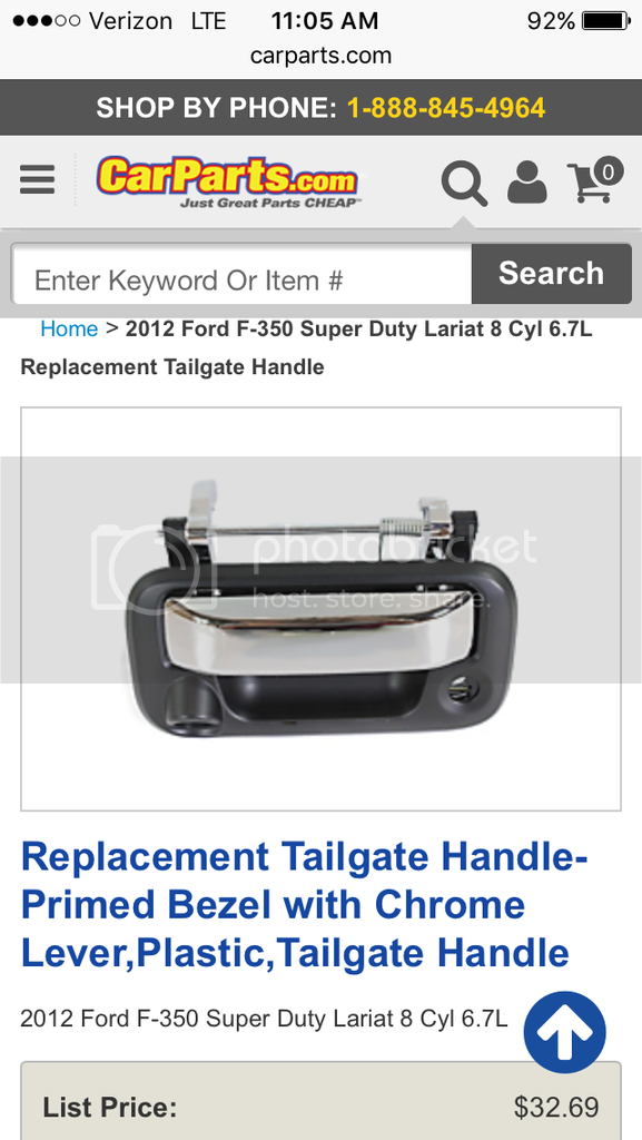

Here is the camera I bought.
Handle that I'm replacing and putting camera in. It wasn't $33 it's under $15.
