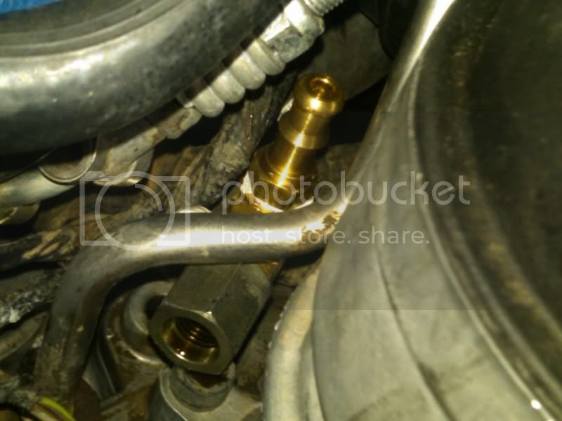

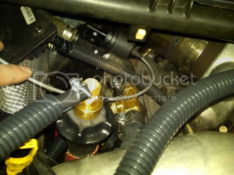

Start by locating your oil pressure switch here. Located next to your oil filter, the one with one wire, not two. Remove it. You can see the hole where the switch was here and the new fitting that will go in.

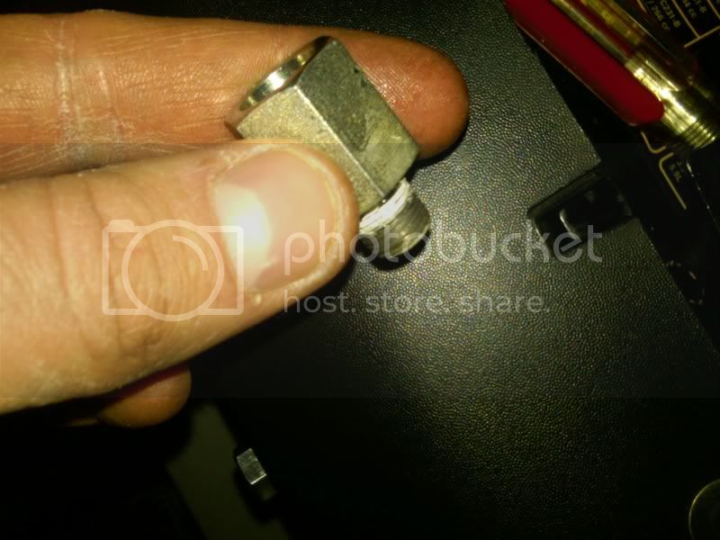

New fitting, #4 oring to 1/8 pipe, then you will also need an 1/8 pipe to #4 oring to relocate the switch later. Gates G60275-0402, and G60291-0402 are the two fittings you need.

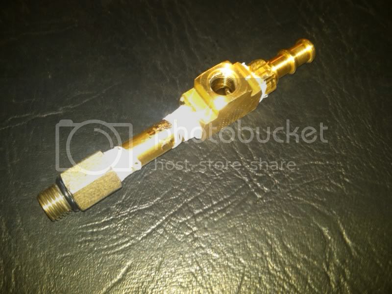

I assembled as much as I could of the fitting off the truck. You can see it below. #4 oring to 1/8pipe, 2" straight to 1/8" tee and then a nipple on top for hose. I later replace the top nipple with a #4an fitting and stainless line for looks.
On the Tee part you'll want to use the 1/8pipe to #4 oring fitting to relolcate you oil switch. The wires are tight and probably could splice them and make them longer if needed.
