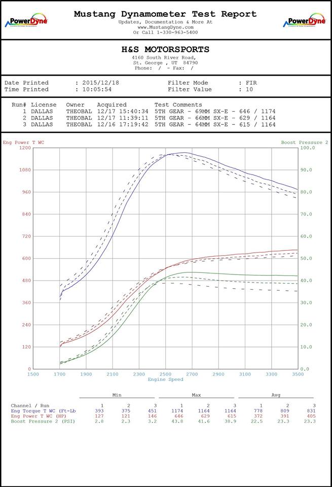

This last week I wanted to do some testing on the new Borg Warner SX-E line of turbos on my truck specifically. We ended up running the 64, 66 and 69 on it with great results. We are very pleased with the performance from each turbo as well as the drive-ability they retain.
Testing was done using the exact same calibration as the one used on our billet 64 setup so the only variable was the turbo itself.
Below is a dyno sheet showing the three turbos and how they compare to each other. Keep in mind that, although these numbers seem very respectable, they would generally be even higher on most dynos. Ours typically reads low but we use it for what it was intended for, and that's a tool.
Since we ended our testing with the 69mm turbo, I decided to leave it on there for a little while and see how drive-ability compared between the best case scenario turbo (our billet 64) and the worst case scenario turbo (obviously the 69mm due to it's size). I was impressed to say the least. Although, the 69mm probably isn't the best towing turbo compared to the smaller turbos, it is a riot when you get on it and very happy under normal driving conditions as the lag is extremely minimal.
