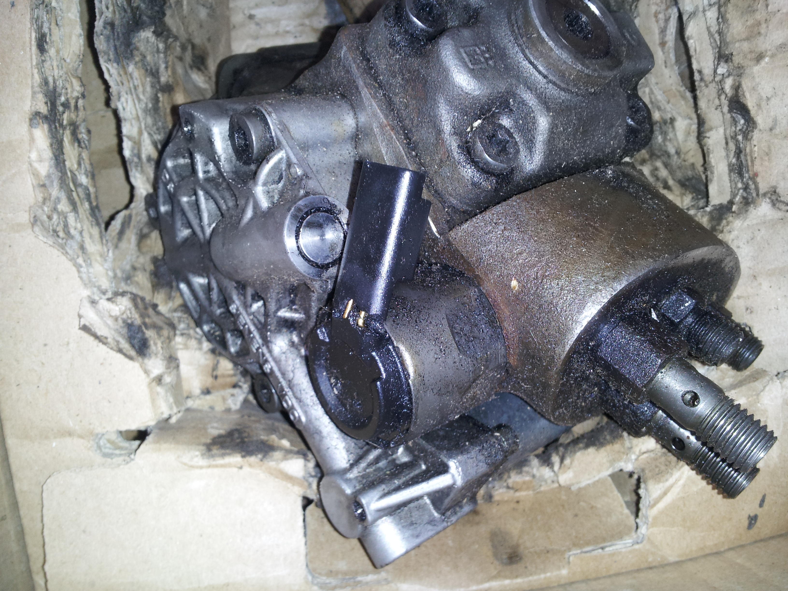

damaged hpfp?
Diesel23
May 7, 2012
957
NWI
hey guys i just recieved what i thought was a great deal ,till i opened it the package had been beat up pretty good , and the HPFP electrical connection cracked at the regulator , i was going to install this in the valley because it has less miles then my stock unit ,with my dual fueller set up. Is this usable or repairable or garbage? or fight to get my money back ,im in a bind because this was like one of the missing peices !!:wtf: and cant find another
and not liking my options i called the seller asap and he just said i packed it well!!

Garbage bro. I just received 2 pumps in the same shape and they are on there way to ups for insurance inspection. From now on I'll only buy new from the dealer, these pumps break too easy.

Just got mine from JIT. All in one piece. He did an awesome job packing it. If you can find someone with the pressure or regulator valves, they are replaceable

could i just use an epoxy to seal the connection where its broke ? since wires are not busted

You can but theres no guarantee it will work. If thats your aux pump than i would try. But valley pump no way

I agree
It might be worth a shot. From looks alone it seems them wires are there and intact, but hard to say. I'd at least give it a shot, but I would still try to look for another one in the future.

Its not really whether the wires are broke at the crack but where you cant see the wires where they are soldered.
