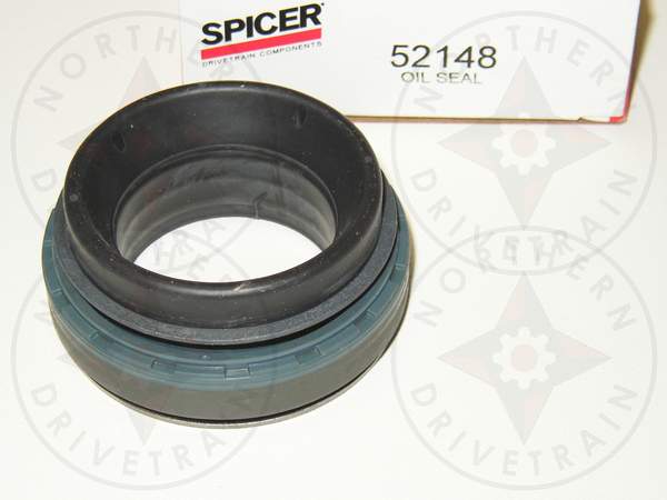

Ordered some parts to reseal the center section. Pretty happy with the customer service at Northern Drivetrain. They also had decent prices on the Spicer stuff compared to the other places I checked.
SPI-52148
Inner axleshaft seal

Northern Drivetrain, LLC: Spicer 52148

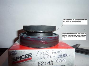

The fun started when I went to put in the new inner axle seals. I wanted to used the SD style Spicer 52148 or National 710493 which are made by Foshida. I wanted to used these as the inner axles did not look the best at the seal surface. I had previously read that you have to take down the edge on the inner part to fit in the counter bore on the tube. I did that but did not take off quite enough, which made for a problem. Next snag was that these seals are stupid tight in the bore. I tried for a long to get them in without success. I finally had to sand a taper on the edge of the seal to get them started. I am not quite happy still so I think it is time to give this another go tomorrow with some fresh seals. I do not want to find out these leak and have to go through this again. It sucked with the axle out bad enough.
Good info here: http://www.pirate4x4.com/forum/showthread.php?t=878575

funny, I've never thought of sanding the seal edge, I've bounced seals around for an hr before trying to get them started, looks good Tom.

Tom,
I had the same problem.
I modified the seal the same way you did too. So far no issues as my oil level hasn't moved. I also installed the outer seals someone posted above so I figured it would never leak out the ends of the tube again regardless. Might just have to add more lube if the inners ever fail.
When I installed the axle shafts, I put a small screw driver or something between the inner face of the seal and the carrier bearing to prevent the seal form pusing too far back into the diff housing. Does that make sense?
