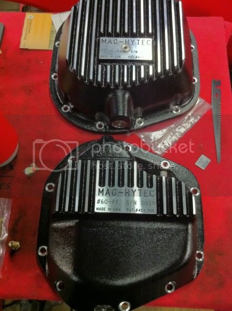

The Mag-Hytec one I have is VERY thick on the bottom and in the front. You'd really have to hit something hard to smash it. I'd be more worried with hitting my tie rods and stuff if I went off road.
These trucks usually aren't very good rock crawlers anyways.

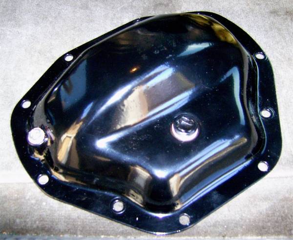

Tom I did both my 60 and 80. I can't find the 60 pics right now, but took a 3/8" NPT coupler and welded on the bottom for a drian plug. Worked out great. Then I powder coated them.. Here is the D80 cover. D60 looks similar for drain plug.

Powdercoating is a decent idea, I have a good guy for that. I also like that drain plug idea.

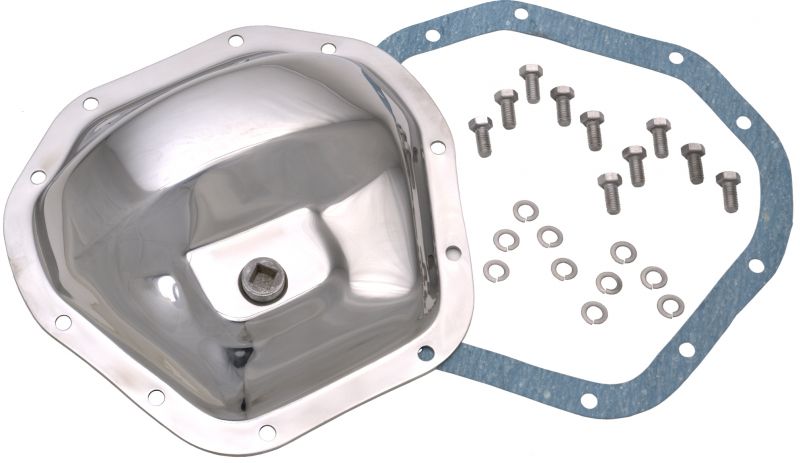

From the pic they just look like a factory stamping out of stainless. Definitely be an upgrade from the chrome ones that rust out quickly if you were looking to go that route.
