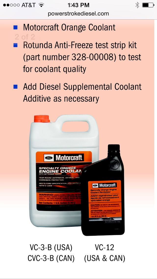

I'd do the coolant swap when you do the EGR delete....The coolant can be reused, if it's still good. If you want to get new coolant, you'll need 3 gallons, a bottle of coolant additive, and the test strip kit to check coolant additive.
See the attachment for the coolant you'll need and additive
Thanks!
I was under the impression (for some reason) that I could use a regular coolant.

I am fairly certain that the additive was only needed if your coolant needs a boost after testing. New coolant shouldn't need the additive.

i have been to 3 different ford dealers around the country and inquired about coolant, additive, and test strips... all said they never have seen one need additive or fail the test strips..
my budy at my local ford house sold me the additive below cost because he said he was required to stock it and he hasnt taken a bottle off the shelf since the 6.7s came out.. had about a 1/4 inch of dust on it... must be the coolant is good stuff!

So would it hurt to put the additive in the new coolant anyways? Would there be a benefit down the road or help prevent corrosion, as time goes on?

The CAT ELC is badass on the older strokes, just havent done much research on the 6.7s that use it. I'm sure its perfectly fine to use. So I guess scratch the additive part and test strips lol
