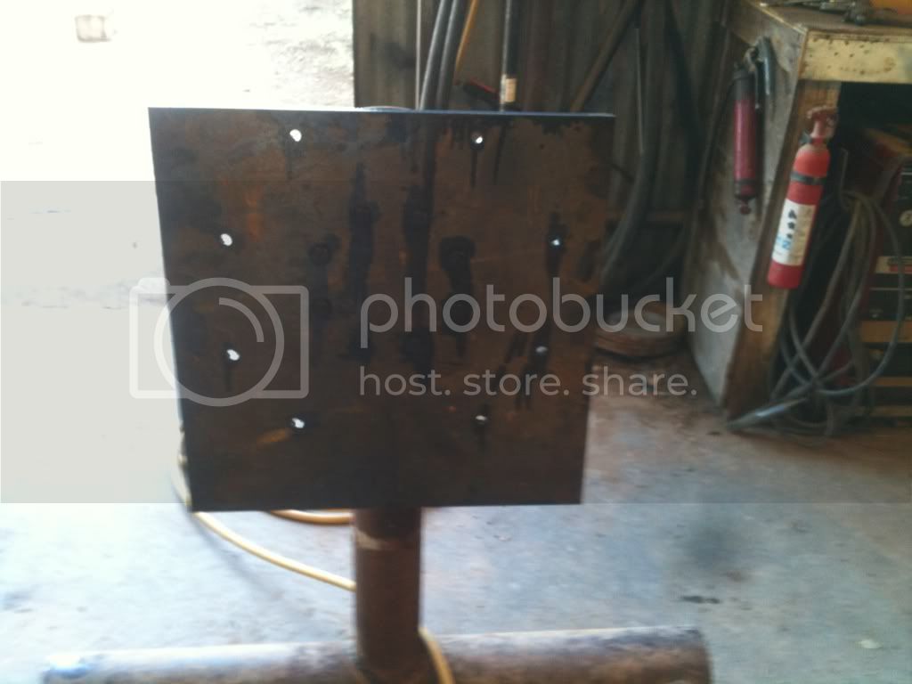

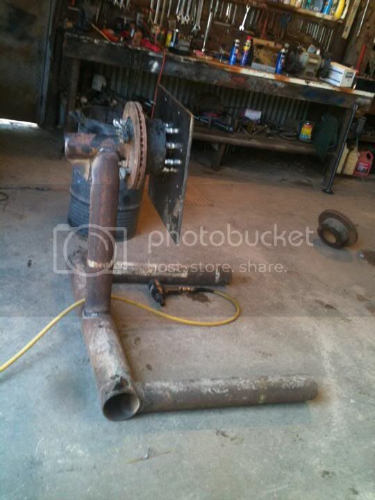

here ya go Matt, Made the end out of a sterling 10.5 and use the parking brake to keep it from moving when I dont want it to. Works great. Im planning on making another one with the other end of the axle at some point.
