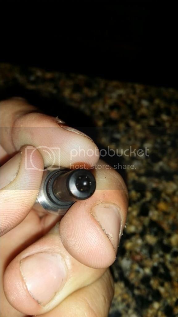

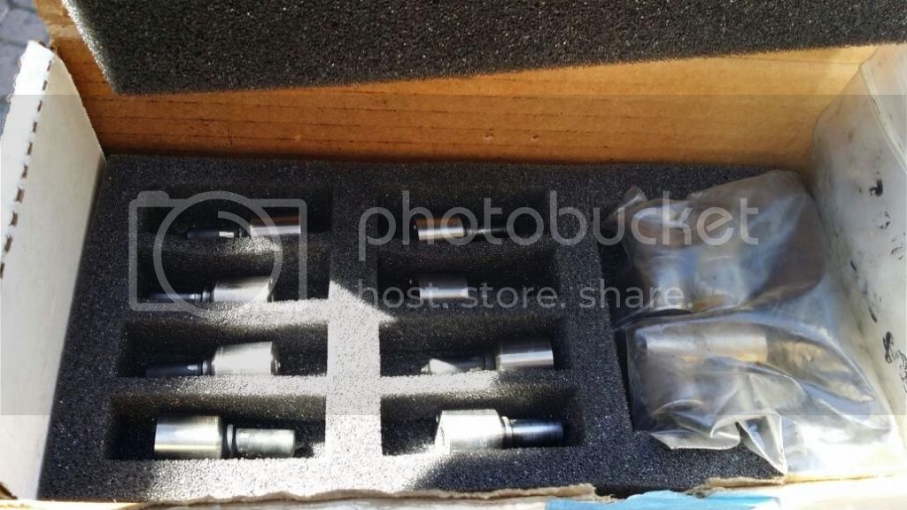

Getting a care package from Moroni :evil
Building 355/250 injectors oil side of a 295
