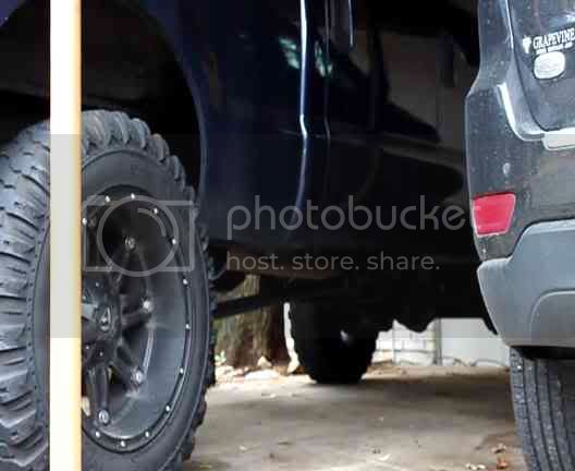

here's mine after a 30+ hour sit. bout 35 outside. mine seems to romp a lot faster than yours.....who knows.
SIX_OHH
In the Brig (Banned)
2,306
Stroke of luck. your truck is about as pleasing to look at as really good porn.
chappy
898
Marshall Mi
Yeah stroke that is what mine does at those temps. I don't consider that a romp myself and nothing close to the op's truck. I think thats the norm with colder temps.
