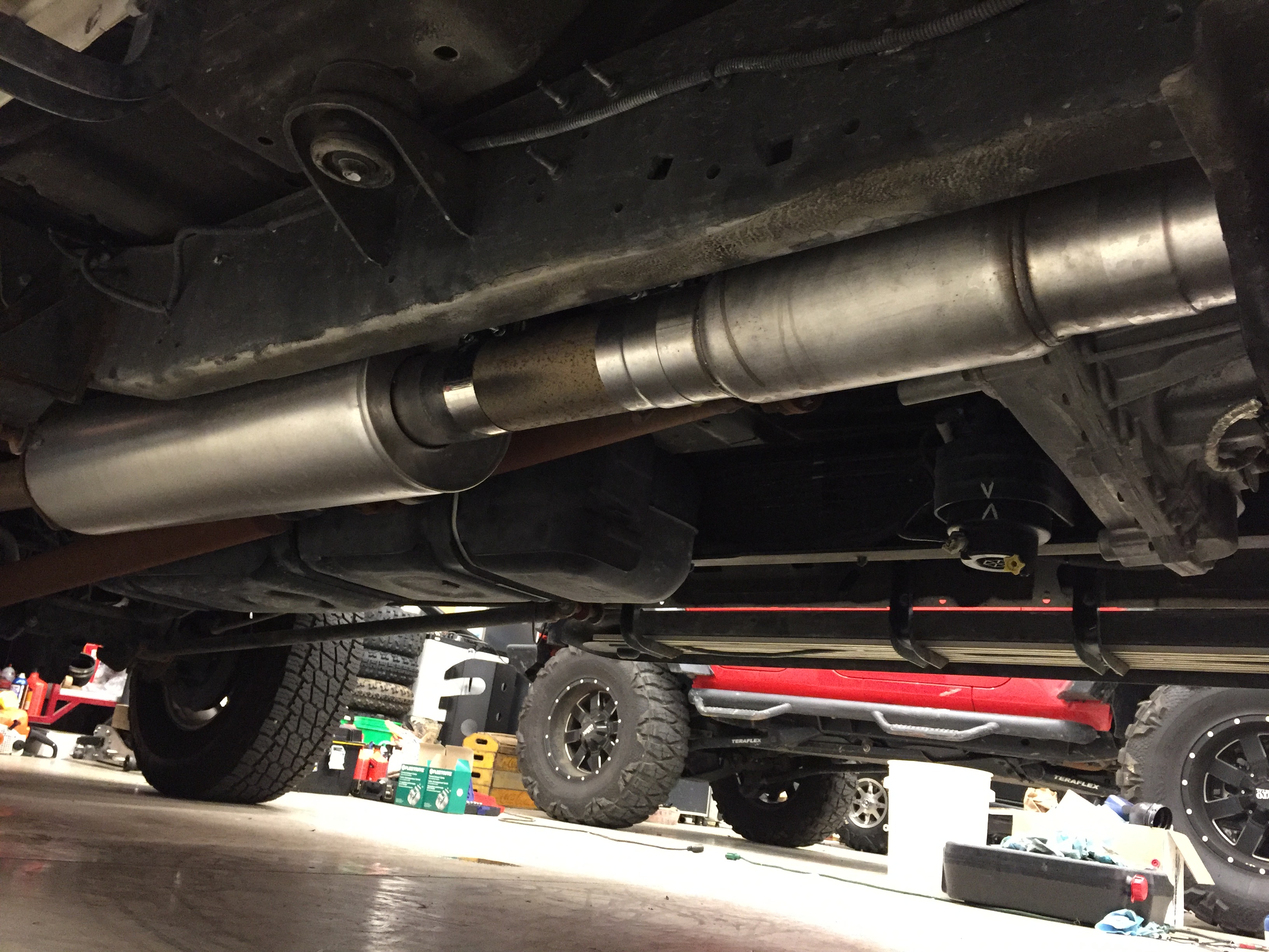

I've got a 40" on mine with a 17" FTE resonator in front of it. Sounds stock! Other than I have the same whistle mentioned above.

Did your 40" have that chamber before the muffler section? Thr whistle became significantly more pronounced with the fte resonator in front. Which I thought was the sole cause, until after I removed the fte and found it was still there. Just less obnoxious. The combo sure takes care of the drone though.

Yes it does. I have the same muffler you do. I thought the FTE was the cause also! I love how quiet the ride is, so the little whistle don't bother me too much lol

Yea I agree. The combo is super quiet like stock. I think I'm going to fill the expansion section and put my fte back in place. Definitely a good drone killer. Sorry to muck up your thread OP, but it's not often discussed like this !
