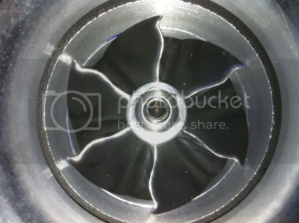

who's adapter flange is that in the last pic? Can't wait to hear some results from this charger. So i'm assuming the drain line from the turbonetics pedistal is a rubber one, but what kind of fitting are you using for it to go into the HPOP cover?

They give you 4 inches of hose, to cut in half. Shown in the parts pic is a aluminum u (sort of) that connects to the pedestal drain with 2 inches of hose, and then the u tube bends back to where the stock drain tube was disconnected with the other piece of hose. Then it has a braid line to do away with the stock oil feed.

not a big fan of the looks of the turbonetics pedistal kit. I like the looks of the BD pedistal and drain line alot better. Hope it works good for ya tho.

It's got some serious welds and seems to be a quality kit . Everything you need is there. As far as ease of install...we shall see

I have had the Turbonetics pedistal and drain line.
They are super simple for making quick turbo changes, etc.
I just didn't like how the turbo is held on with 2 bolts on such a skinny flange.
The one I had...the bolts kept coming loose, and I always had an oil leak.
Only solution was to change the bolts to studs, doudle nutted them using RED LocTite.
Good luck, looking forward to seeing how it does.

looks like the kit actually has studs for the drain line to the turbo. I'd love to see pics of the pedistal and drain installed without the turbo and then some with the turbo. How much was it and where did you get the kit? It's definitly 10X better than what i have right now. I'm all for making it simple for a turbo change/install

It was a freebie from Rudys and turbonetics at Rudys inaugural dyno day for highest hp 6.0. The only problem I have run into thus far is the studs that connect the
Pedestal to the turbo are too small and do not thread into the turbo drain but not a biggie just had to get the correct studs.I will post pics step by step on the pedestal and oil drain before the turbo goes in.
