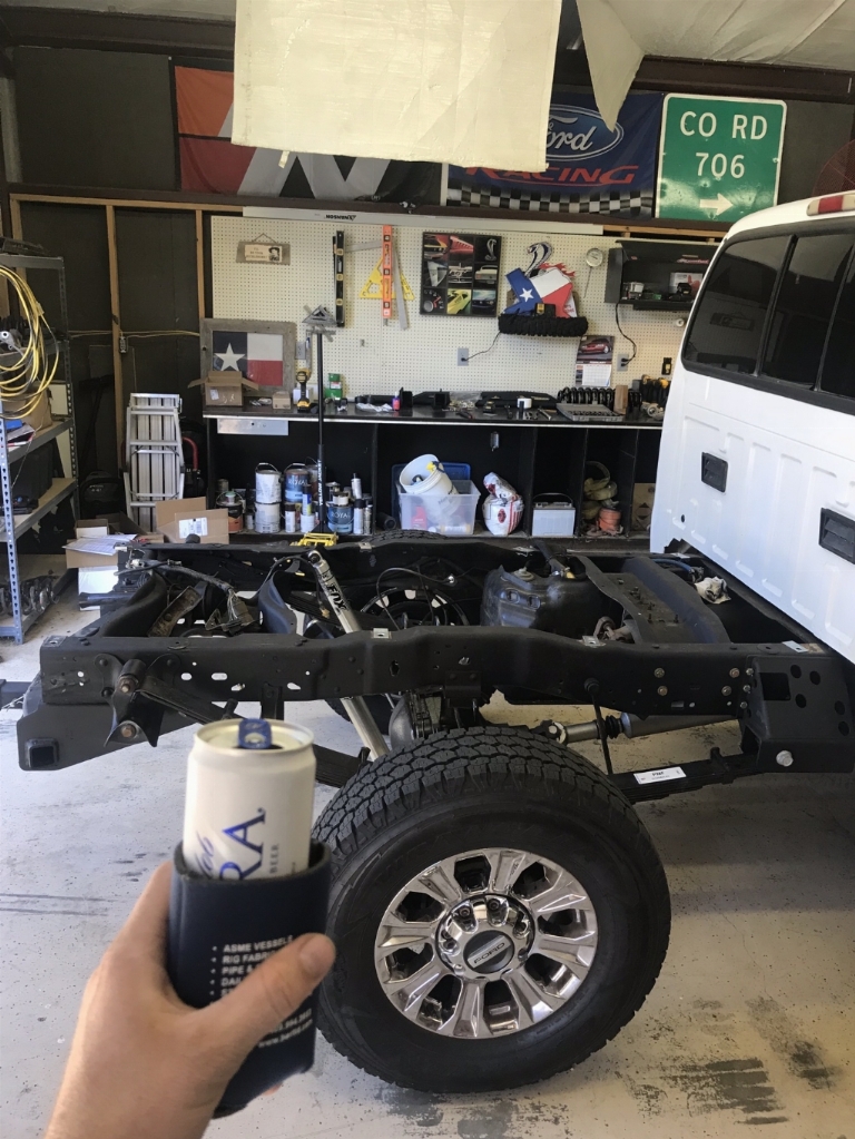

Pic of the rear complete and torqued. Cheers to that

What you see there is a shoe box - wife’s new shoe box. Eating peanuts and drinking bud light - she don’t want me to make a mess sheshhhh

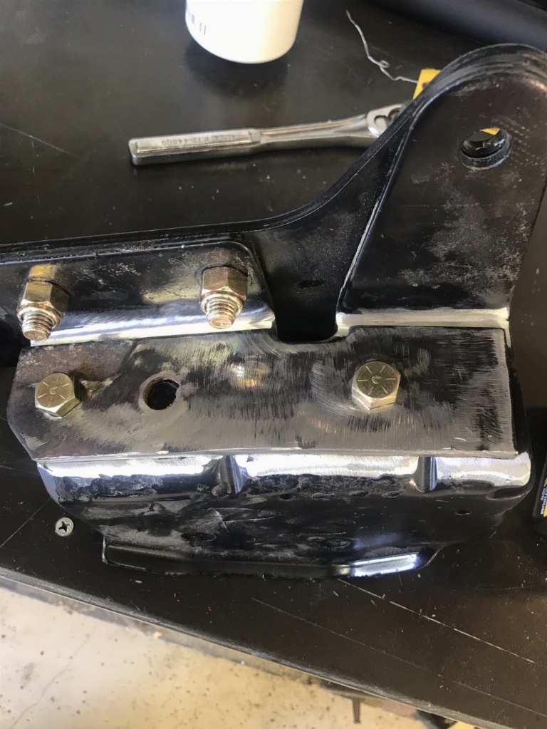

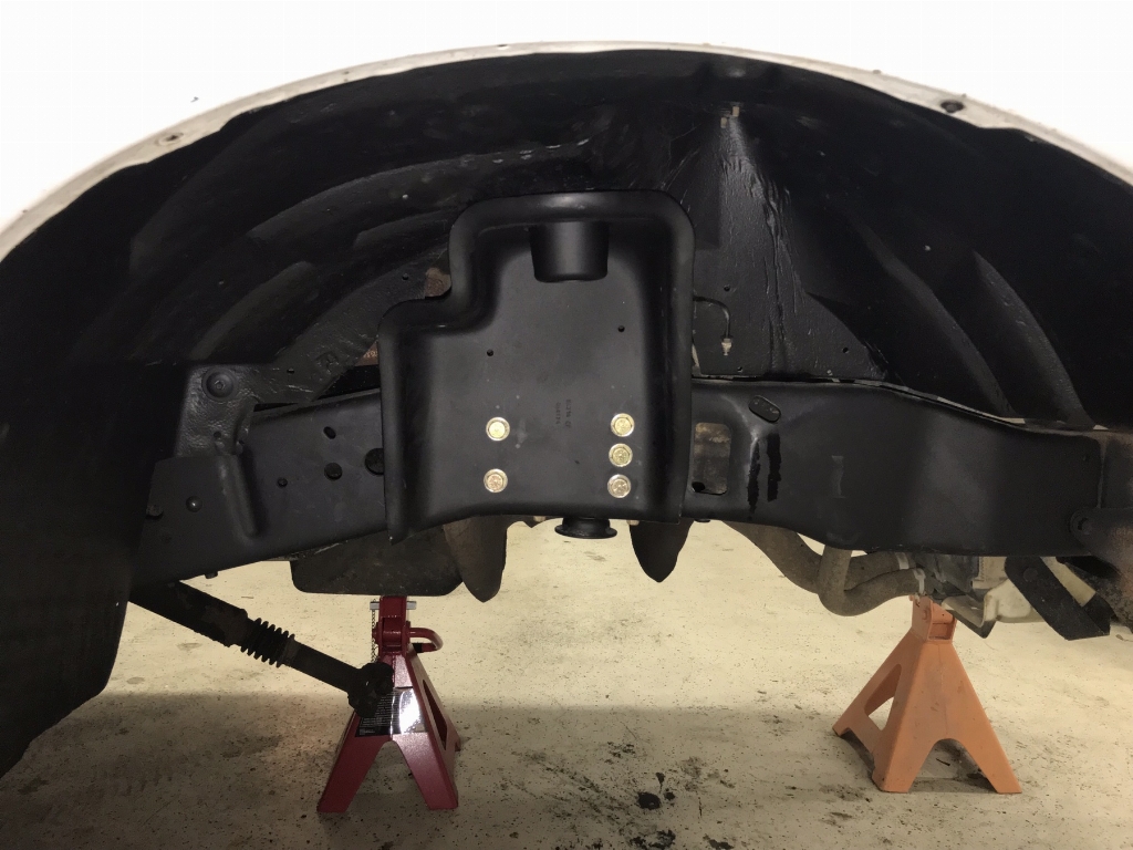

When the radius arm brackets are installed there is a perfect 1/4" gap between the bracket and the frame. The guy who's thread I followed cut out a piece of 1/4 plate and heated and bent it to conform to the shape of the bracket because of a slight angle that contours the frame rail. I lucked out and ended up with two sets of radius arm brackets. I used the worst pair to cut the already contoured piece of the bracket off then bolted and welded it to the bracket to be used on the truck. Hard to understand how I'm describing it but you can probably get it if you look at the picture close.

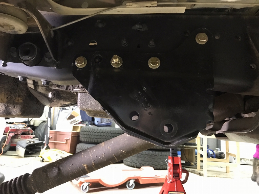

Passenger side bucket in which was a breeze. Literally look 10 min including drilling holes. I think 4 out of seven match up fine

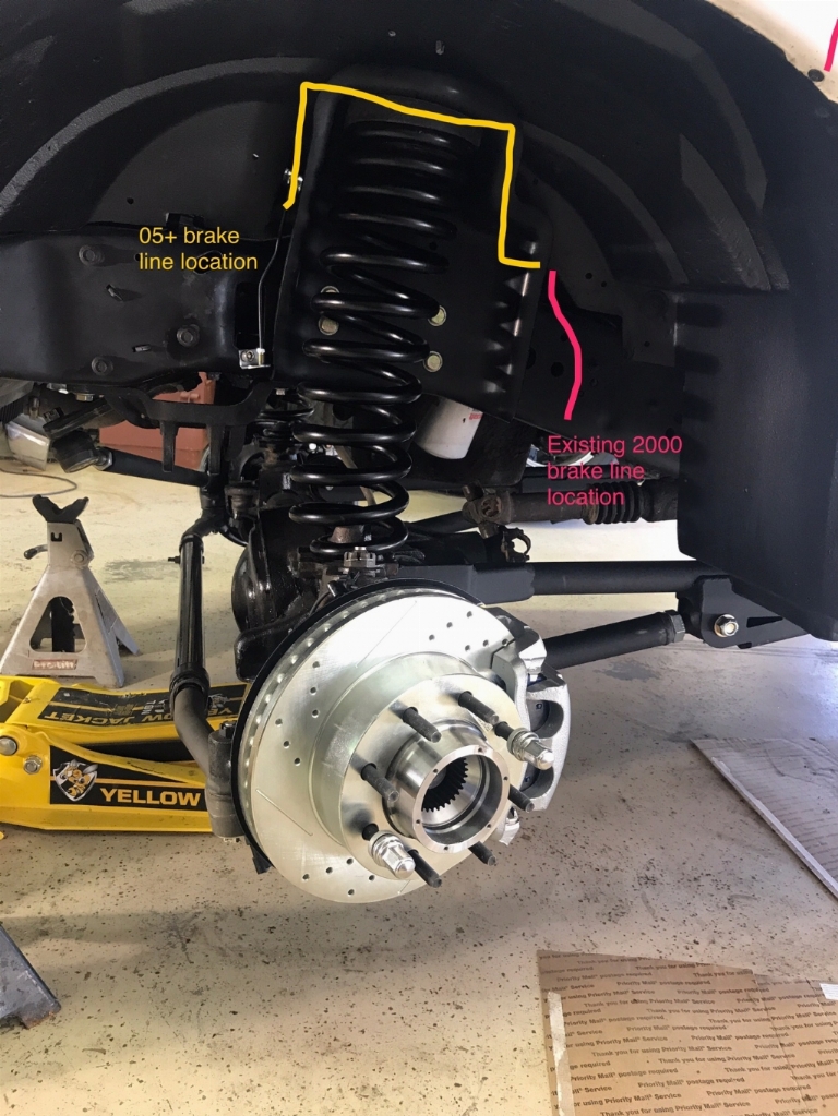

To touch on this side again, I forgot to mention brake line issues. You can see in the picture where the existing line used to run, and where I needed to go with the new axle. The existing brake hose was essentially a T that connected the master cylinder + front driver and passenger together. I replaced the existing hose with a 3/16" standard thread inverted flare T and ran a new line over to the front side of the bucket. The picture shows the line ran all the way down to the bottom of the frame to anticipate for extra travel for the line. I ended up cutting the line back to where my markup line stops and mounted the new bracket in the existing brake line bracket hole that's threaded into the bucket.
I also forgot to mention I installed a new red head steering gear pre tapped for hydraulic assist, all new power steering hoses, and did a power steering flush using royal purple synthetic ATF.

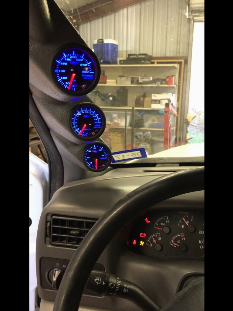

So now I have moved on to the performance phase of the build. I have the gauges and tuner installed so far. I ended up going with the glow shift 3 gauge kit from amazon. The reviews are questionable, but for the price they fit my budget. So far I like them, they look awesome but I don't really have any miles on them so time will tell if the quality will be long term. I went with the Hydra simply from a convenience aspect of being able to manipulate which tunes I want and what position when ever I want from my own laptop. Coming from a Hypertech Power Programer 3 that my dad bought new in 2000, to the Hydra tunes should be pretty noticeable.

Okay my gauges are some chit name VDO or something like that and they still haven’t broke. I was looking at the one deal with 3 gauges in one. I’m going to get that for my 4x4 since the ones on the dually just won’t break.
About the hydra - make sure the key is out before you fiddle with it- don’t be a dumb (__!__) like me and burn two pcm s 🤦Then pay good money to have swamps fix it smh.
Yeah apparently it's pretty easy to forget. It says it in big letters about a dozen times in their instructions.
This is the kit I ended up going with. I really want a riff raff F650 dash kit with a Hydra pod size tune selector to fit in one of the pod holes, plus a fuel pressure gauge. That's on my list of stuff I want but am running outta cash quick. Lol.
