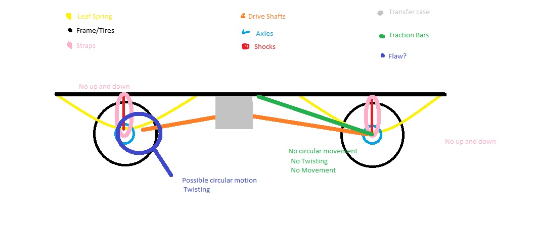

Drawing a piss poor picture to see if i can come up with something. Traction bars....working on it.

Surprising to see you "help me":toast:
How rough is it? Times? Worth it? Did it kill anything? 20 psi has got to be stupid hard on a tranny?
Is there a such thing as front traction bars? How much circular travel is there?
This helps me get it but there seems to be one flaw. I just think if everything is solid then nothing except u joints and stuff will break. It seem more efficient to put power to the ground safely.
Dont laugh at my pitiful pic its 5am :doh:

Don't need to strap the rear. Also, traction bars need to be at same angle as the driveshaft otherwise it will bind. Just get some caltracs, they work.
I never ran on the strip, only street stuff. Very little to no spinning but with 315/75-16 toyo MTs I don't think it was going to much at 400rwhp or so.
I have seen front traction bars but usually on sled pullers. With the springs compressed and strapped it makes it harder for the axle to twist the leaves and rebound, which causes the hop. Loading and unloading.
