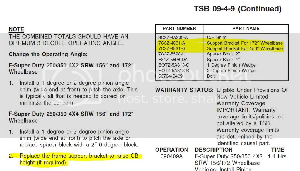

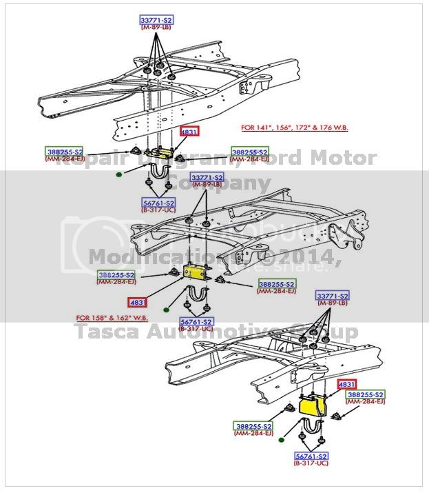

Ok guys, help me out. TSB 09-4-9 shows that you can change the support bracket for the carrier, and it gives part numbers but it does not give dimensions. How do I know which one I have and which one I need?
This is the only drawing I can find that shows 3 sizes, but none give the PN of each, just 4831. By looking at mine, it "appears" to be the middle one, but what PN is the top one?
