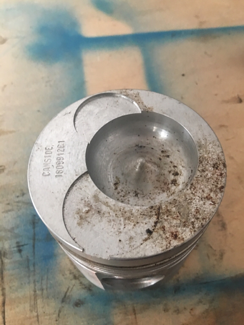

Has anyone Delip these Pistons to lower the compression any? I'm going to balance the rotating assembly anyway.

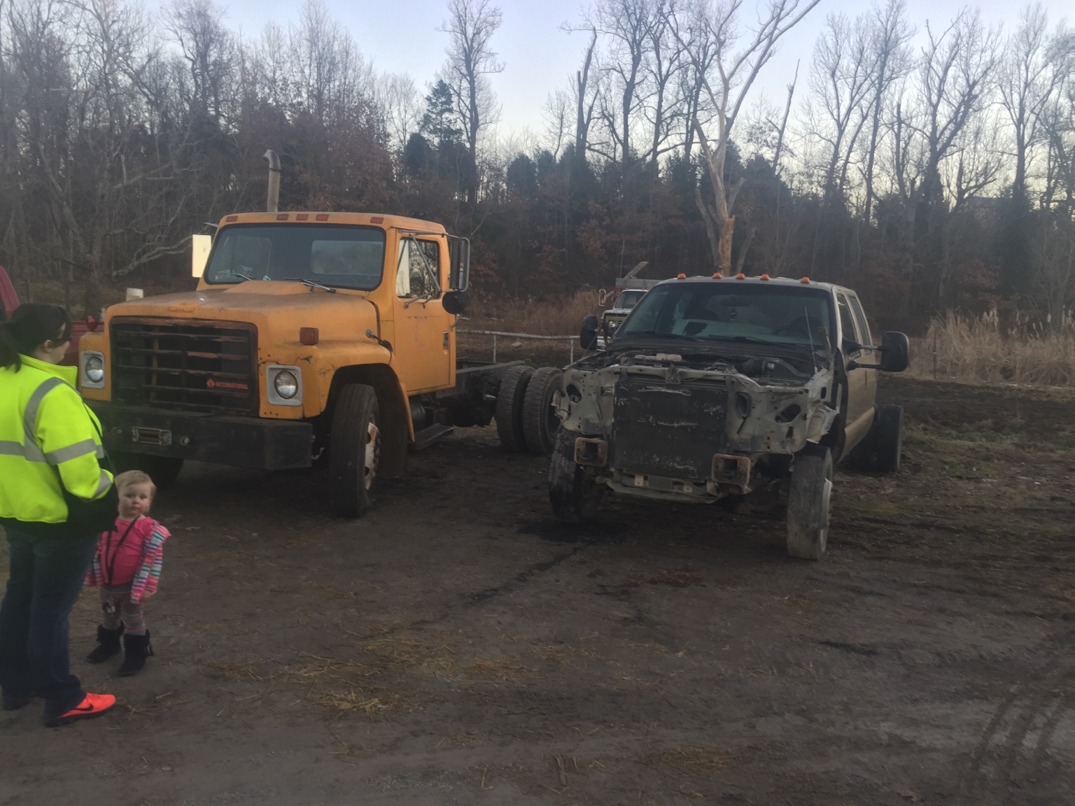

Nice! Do you just plan on parting the rest of the truck out or scrapping it?
Parting it out but if it sits long scrap yard it.
It's has new virgin rubber on the front and two new tires on the back. Should come out okay on it
Truck shows 69k but has reman motor and trans.
