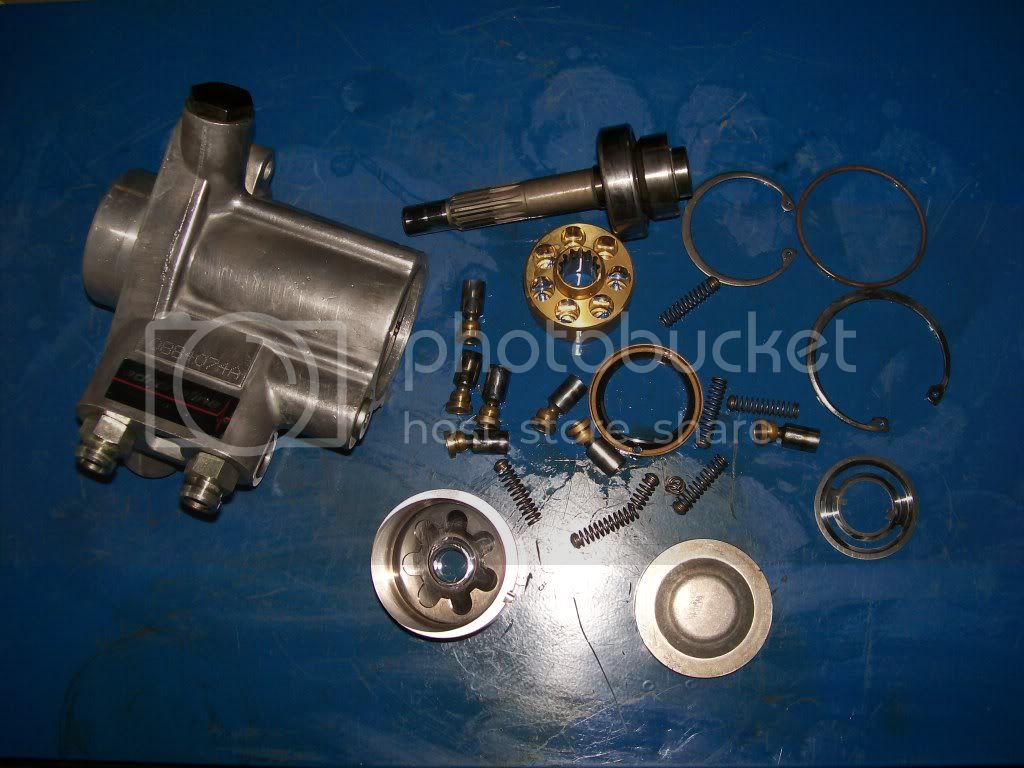

Not sure about a big single but, after reading an old post on TDS i'm thinking about a set-up like Suns-PSD. Run dual IPR's and have a line going to each head from the gear pump. Just gotta get some other crap done, trans built(hardest and main decision right now), then i'm gonna start working on building a HPO system. Still have tiny injectors, but its a start.
Now i guess what i was getting at, is what about splitting the lines and feeding 4 ports instead of 2? I guess without building a pump(Stealth) with 4 output ports you can't really have a quad feed. Unless it'd somehow be possible to tap the HPOP for 2 more ports, although i know it can't be or somebody would be doing it. :shrug:
Really wish i had a junk pump to cut-up and see what they look like inside.
