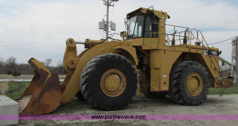

Any body ever see a cat loader with a single hydraulic cylinder to lift the main boom? Yea I didn't think so..
not that I care about dual or single
but what u mention is simply a design constraint not an endorsement for duals IMO the chassis is in the way to mount a single there is plenty of pressure on the bucket itself also and plenty use a single ram there

Im sure if you checked with the engineers that designed it that way, there would be way more to the story then that. MBA's also have something to do with it. Its not like they dont manufacture the chassis around the work it does, they could build that chassis any way they needed to be. That machine is built to dig. Think about the break out force needed when scraping out rocks. Now think about it when its only on one side of the bucket. With a single ram, your hinges, and steel where the hinges are mounted need to be significantly stronger if they are taking all of the twisting force when digging from one side. Now if your lift is also supporting the bucket, You take stress off the hinge. But I dont think we need to get into heavy equipment design theory.
But, if they wanted to put a single ram on one side. They could have.

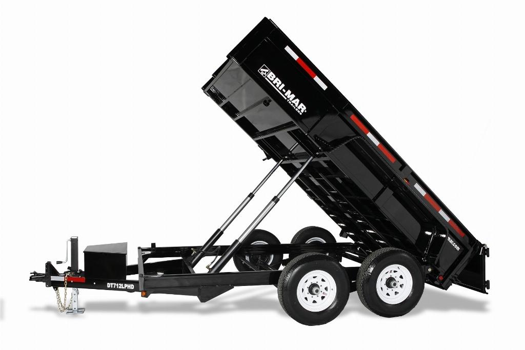

My bri mar 7x14hd 14kgvw is dual 3" telescoping piston. Never had an issue and it gets used 3-4 days a week and always loaded heavy, gone over scales at 26-28,000lbs and truck and trailer empty is 11-12k

I mean, you can say what you want. Bri-Mar is one manufacturer that makes 'em that way. My uncle has had one a very long time. We have used the absolute sh!t out of it over the years. Its a 14k rated trailer.
But again, Im not getting into a pissing match about this. The picture representation of what is "right" and "not right" is again, manufacturer/salesman bullsh!t.
And I still refer to my original statement. I dont care what method of dump hoist it uses. Just what the hoist is rated to lift.
And likewise, everyone is entitled to their own opinion, just like you are yours. And the reason for the comparison to heavy machinery was because they are built to lift and dig. And utilize hydraulics. Showing the manufacturers claims to be futile and foolish.

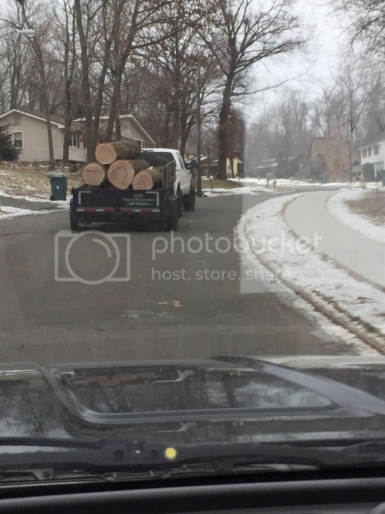

Exactly, as long as you have dexter axles i doubt you are going to have any issues... My trailer probably has over 50,000 miles on it in the 3 years i've owned it and its fine, dumped this pile of 14' oak logs no issues. And that was a heavy load...

The Brimar 14k, 14' trailer my uncle has, has been loaded like that several times. Same thing, no complaints, always dumped when loaded heavy with oak logs. The slowest I remember was when it was full of 2RC stone.
