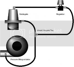

how do you have the WG hooked up/plumbed? what is your current adjustment on the manual controller, if you are running one?

One line from boost source to the side port and another running threw the regulator to the top port. I had it building in the high 40's when I left so maybe he developed a boost leak.
Pog try tightening the clamps a bit. If that doesn't work bump the wastegate controller up a bit, maybe a 1/8 of a turn.

Try this set up and 1 1/2 turns. Turn counter clockwise until locked and turn it clockwise 1 1/2 turns.

I tried that. My boost wouldnt get past 32psi. Im at 2 1/8 and its building up to 41psi with 68 eb

That's how it is hooked up Beefy.
i figured you did. reading it from my phone i thought you had the side port open on the WG.
