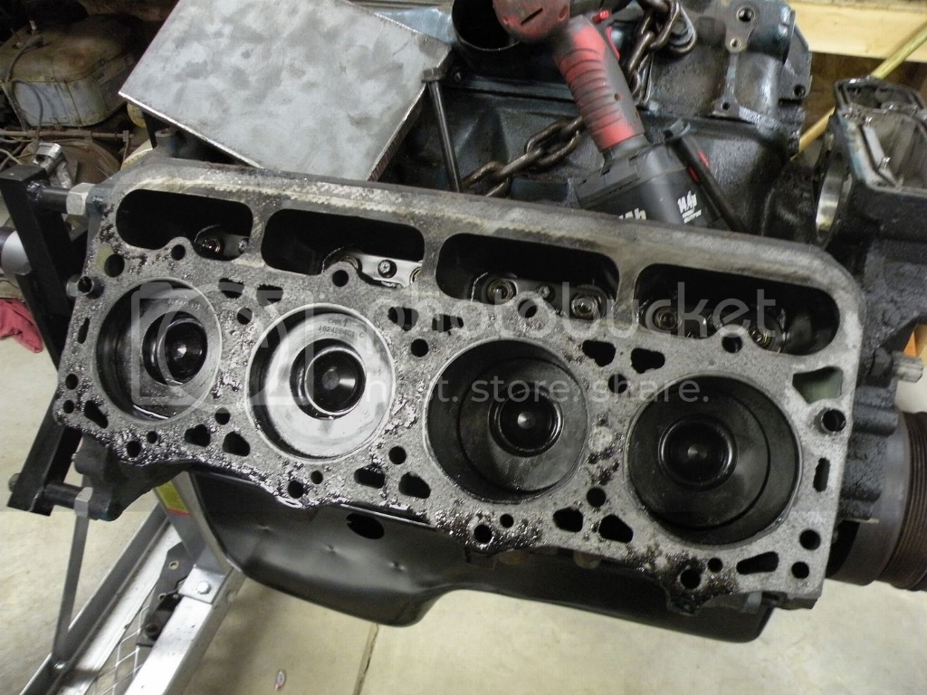

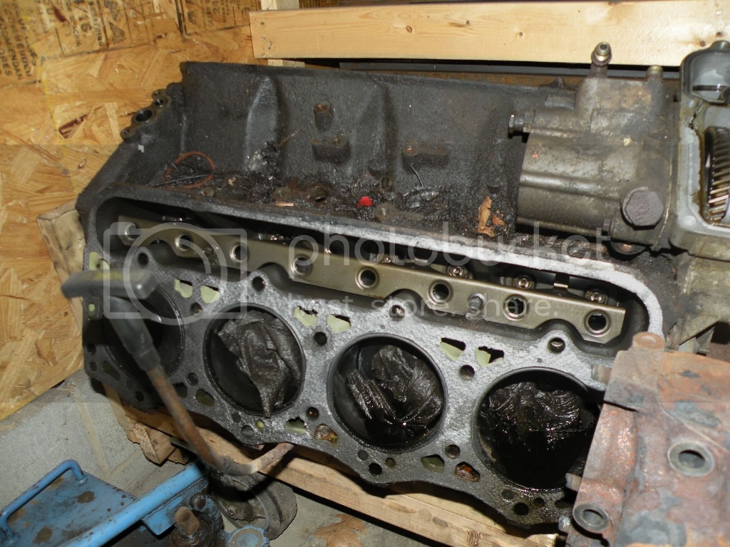

Couple pics of a 95 vrs a 00 with the heads off to show the upper end webbing (or lack there of) -
(sorry for the large pics, damn photobucket won't let me shrink em)
The 95-
& the 00
Haven't set the cranks side by side but we can check when we around to tearing the 95 down.

Yea I have pics of the blocks and the cranks in a pdf thats in another thread here. But those pics you posted of the blocks show exactly what I'm talking about. Just wondering if that web is a strength issue I should be concerned about.

I was just trying to figure out about this webbing thing. I was just with Jody yesterday and he mentioned that one has webbing in it. We didnt have the time to look in the covers but he said the mid 96 and up should have the webbing,according to Jacob. So the 00 has the webbing? I have 2 blocks on the stand now a 97 and a e99. I planned on using the 97 block. I will check it tomorrow between two blocks. So the block with the webbing is it stronger then the one with out ? In what ways?

Well i just looked at both of my blocks and it looks like its got the webbing. When i look down in there i dont see that plate thats in the lifter valley that goes from front to back. Also when i look in there i can see the corners on the webbing.
