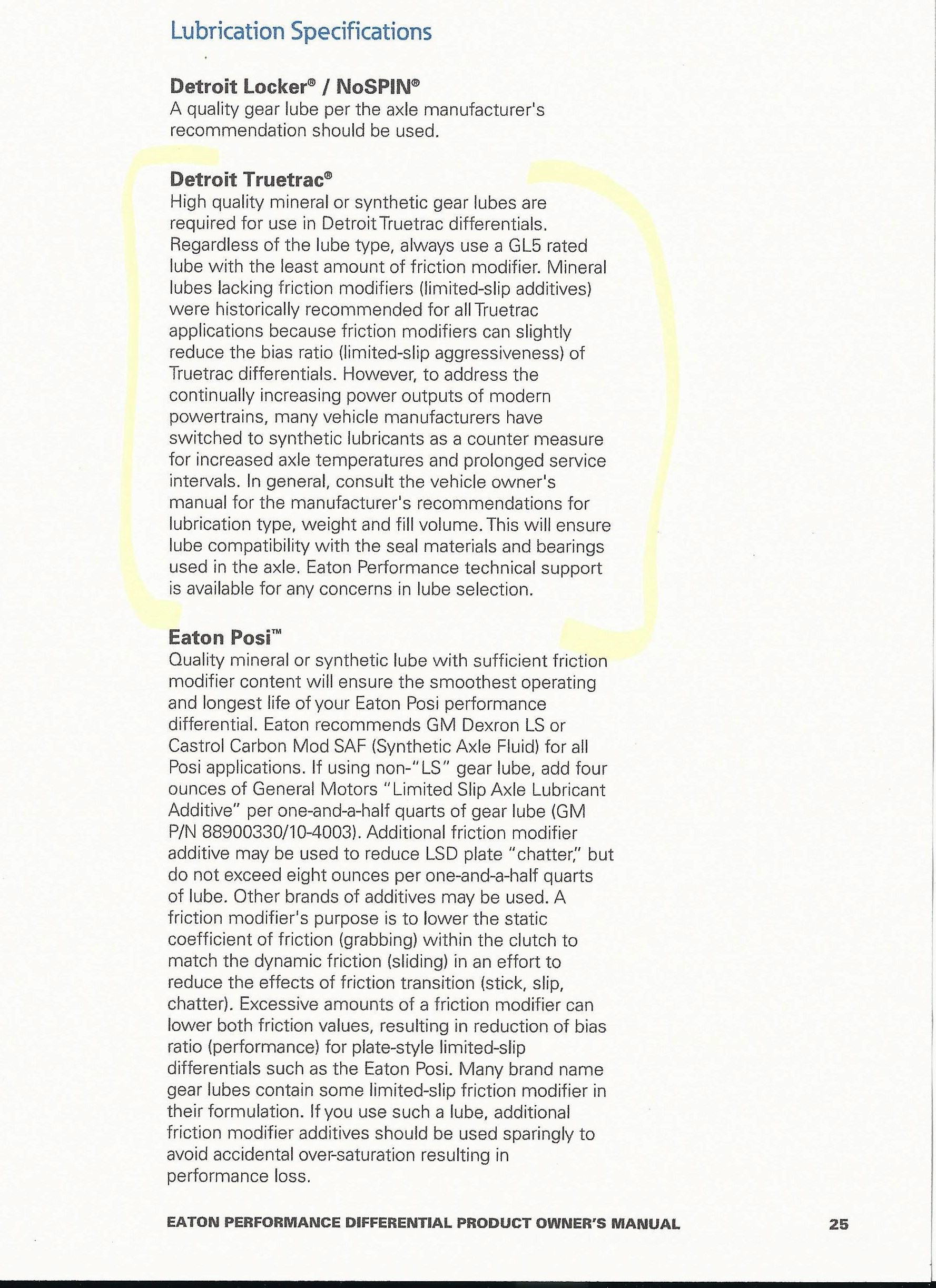

Eaton seems to be more concerned with using an oil with little to No limited slip additives (friction modifiers) in it, as these will reduce the bias ratio (the ability to lock) of the unit. I had 2 pails of Chevron 80w/90 Gearlube in the shop so that's what mine are running in.
  • Eaton_Differentials_Owners_Manual_0314_LR (2).PDF

All gl5 oils should have the modifier in them. And now that everything is called a synthetic I think they are basically not worried any longer. Venom had issues with Amsoil, Royal Purple, as well as our 9919 with detroits and ARBs (mostly ARBs). All real group 4 pao's.
And Chevron... Gross!
