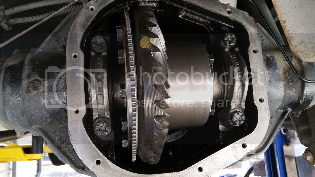

Guys eaton is installed and as everyone has said it's amazing. Super quiet and spins two when you touch the pedal. I'm happy! Here are a few pics of install. Last pic is a quick takeoff on hoosiers with some wheel spin obviously.

Ruben. Not sure on the synthetic part but I do know that eaton told me the regular 80w90 lubricates the internals of the unit better than any other lube. Said synthetic wouldn't hurt it but locker would respond quicker without. I can say I went with ford 80w90 and it's quiet as a mouse. If you ever so slightly spin tires. Your Gaurranteed 2 are spinning. No more one tire at all.
