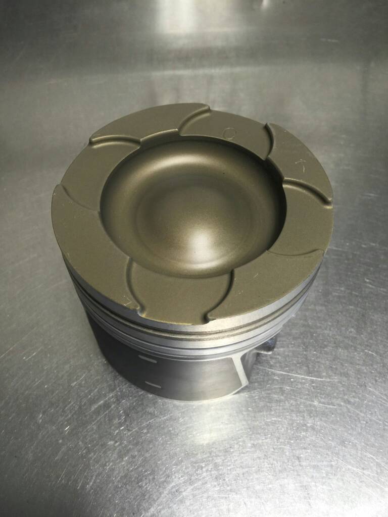

Bump rail pressure up at idle. How crazy did you go with Piston machining?

Pistons are from morgan. Intl HD. I believe they are actually manf. By Mahle ? Anyways. HD piston. Delipped and flycut and hi temp coating by Swain. The flycut does increase hazing im aware.

Exactly what mine looked like. Not gonna idle clean with 4.4ksi rail pressure. The reduced compression and alterations to bowl design are causing the fuel to atomise poorly. Hence the reason that if you Rev it to 2k rpm even when it's cold, it will clear up.

Both bigger nozzles and cut pistons will reduce cold weather performance so I would definitely raise pressure
