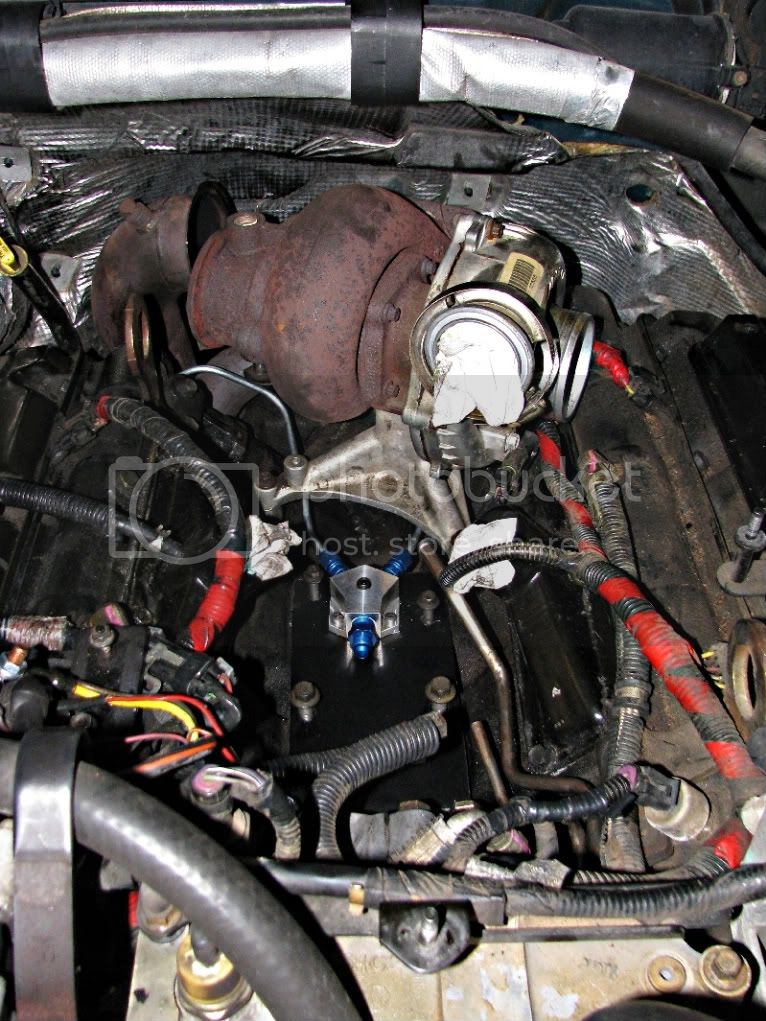

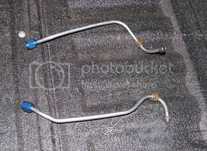

To the back of the heads I built two lines that use the factory vibra-lok fittings.
Then placed a Y in the valley
Your understanding for the return is correct. A single line from each head to each side of the regulator with the return out the bottom.

Did you have to remove any fittings from the head in the back? Or just use the fittings that were in there with the new lines?
Are the holes in the front of the heads merely plugged up? Where did you get the Y manifold?

1. I would not mess with the fittings in the back if I was doing vibra lock fittings like PSrumors did. Advantage there for sure is no chance of cracking the head.
2. The holes in the front are not blocked off those become the feed to the regulator. I did not mess with those I just connected them to the regulator. I used a short piece of tube to extend one line.
3. Jegs, Summit etc will have those Y-blocks. I had bought one from there but it seeped so I ended up with the aluminum air manifold on mine.

On the '97s the rear fitting is a 90 that has to be cut in order to remove. I was not comfortable cutting the fitting for worry of shavings. The last thing I wanted to have happen was to get something in the rail.
If / when I remove the turbo I plan to go to stainless braided hose or something along that line.
I did mine when putting a new motor together out of the truck for the 96. Makes sense to do it the way you did in the truck.
