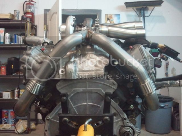

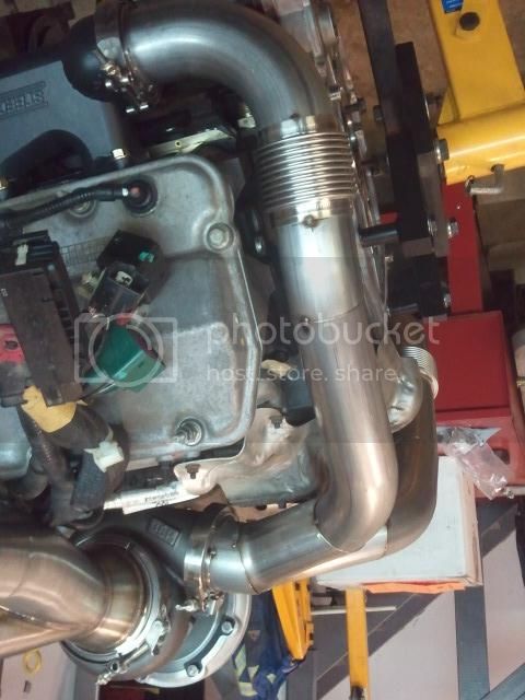

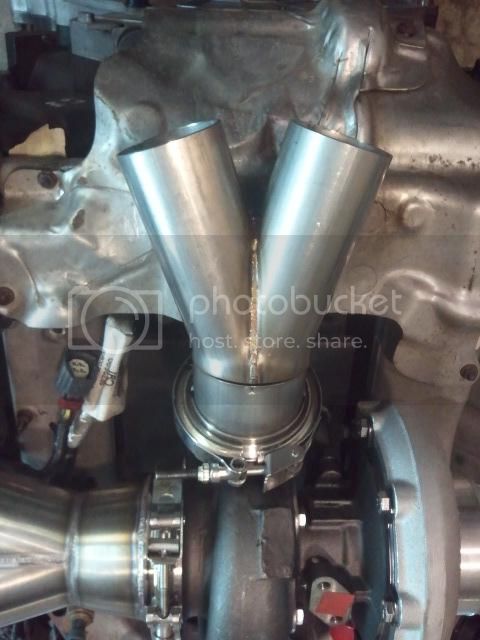

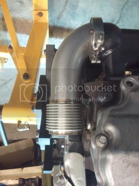

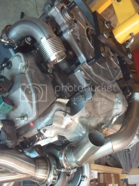

Up-pipes...
... There is still a waste gate to plumb in.

Looking good! You've gotta be chomping at the bit. The 90 coming out of the drivers side manifold looks a little tight though, imo. Not trying to insult so don't take it that way, just my opinion.
It's snowing up here. I'm no longer in a rush lol.
We don't have a lot of wiggle room with 2.5" piping, so it had to stay as close to the head as possible. It's still a clean bend, and with that size pipe i'm not worried about it at all.
