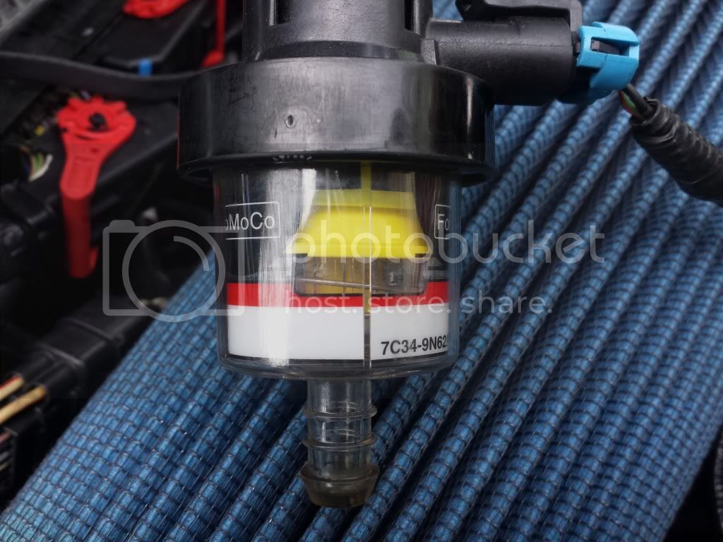

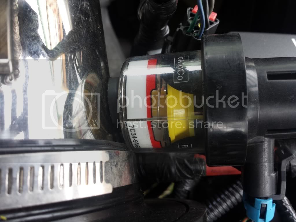

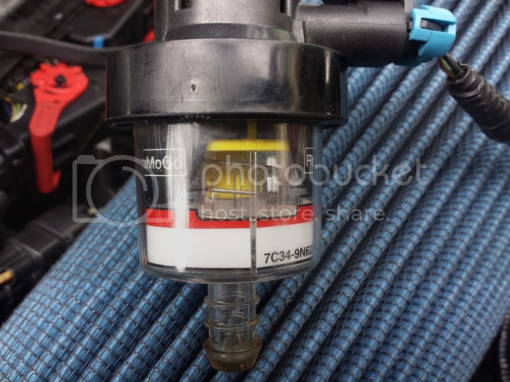

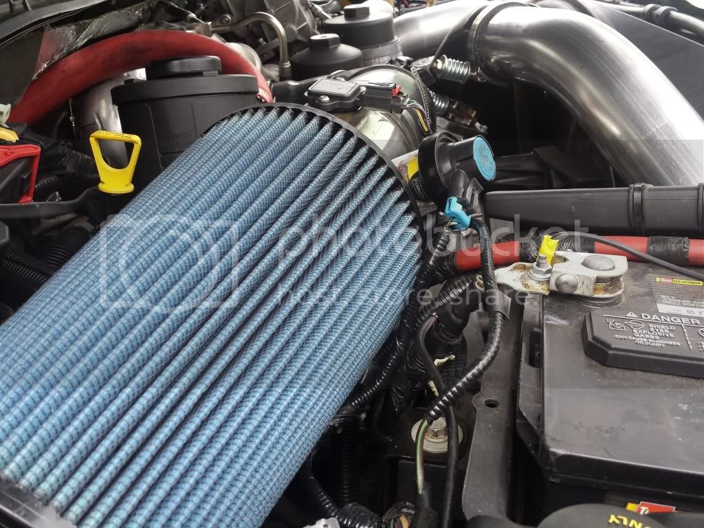

Here is some more info....
With my 72 the minder never moved with my no limit intake.
Given everything a once over today and noticed this
Filter has about 100 miles on it.
Reset it the minder to see if it would do it again and it did.
I think its safe to say the 76 moves a hair more air, even on stock fuel, then a 72.

Notice the first digit in the part number is a 7. This is an outdated minder. I ran into the same problem on mine. When I got the updated minder, it no longer moved. It sure is indicitave of the air that turbo moves though.
Thanks for the heads up on that
roger that.. ill take a record anyway i can get it :) wish is till had that setup.
it must be the out dated minder. mine never moved with high powers, dual fuelers and 110's at 65 psi of boost.
Yes sir its out dated.
In no way shape or form do I think the intake isnt able to handle my little setup.
I was just showing that the 76 was able to move the outdated minder were as my ol 72 couldn't.
Should of clarified it was an outdated minder in the OP.
The updated minder doesn't move.
