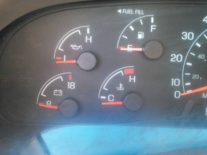

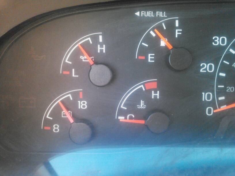

benjamindurtka
Mar 7, 2016
251
Like this when the key is on or running. Hasn't moved at all with 300 miles on it other than those 2 positions. uploadfromtaptalk1459557279796.jpg
Sent from my E6782 using Tapatalk
benjamindurtka
Mar 7, 2016
251
When I put the paperclip in the pigtail and turn the key on I get nothing. I believe that means I need to check the wiring for a short?

TyCorr
Jun 23, 2011
15,461
If the gauge is staying in that spot check the tstat....if the truck never warms up you will have crappy idle and the exhaust wont get hot it'll idle like you just started it.
