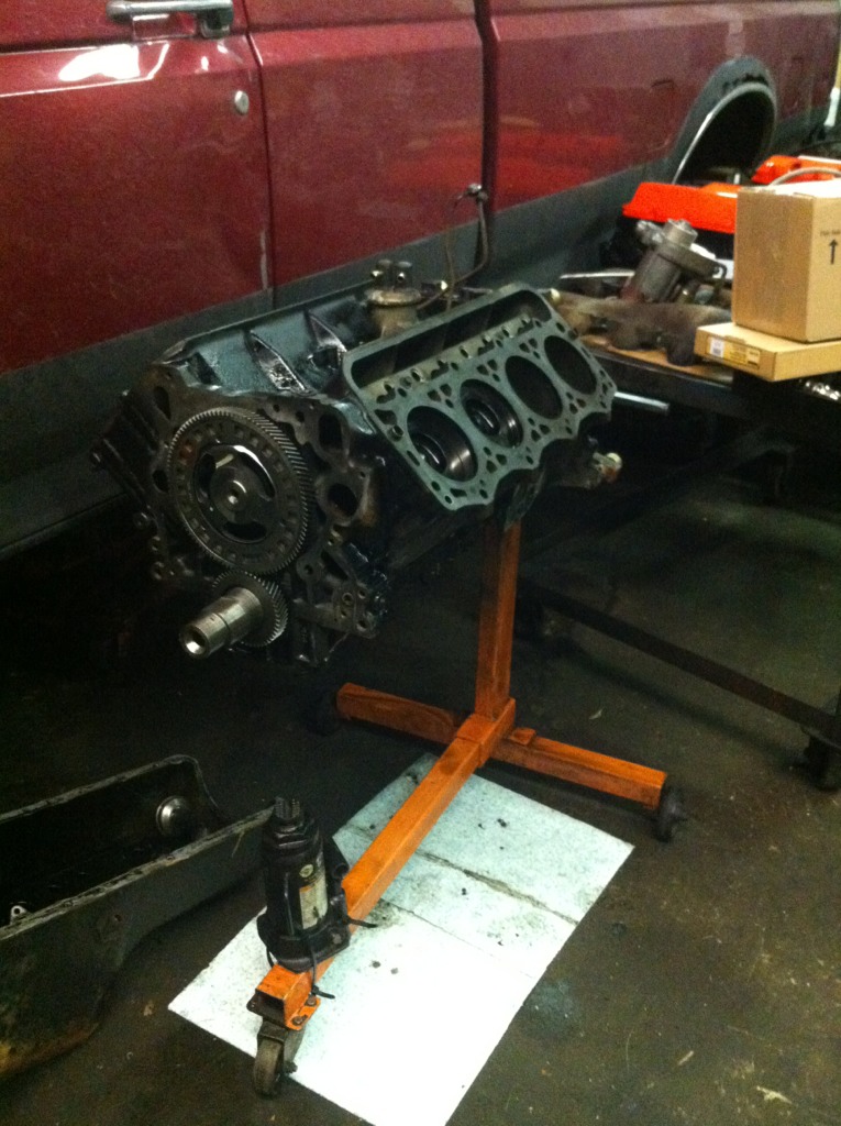

I'm in the same boat as you. Getting ready to weld the cam gear install welded oil jets and stick all my parts on this engine.

You've got the heads off, so you've gone farther than i am. LOL

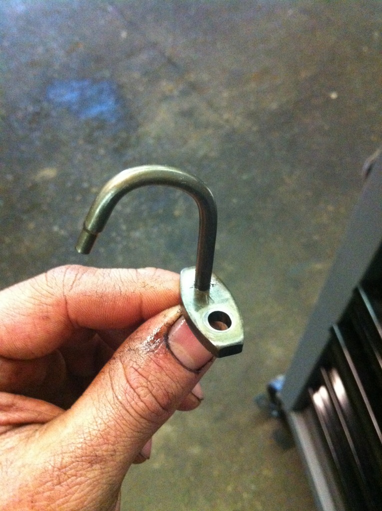

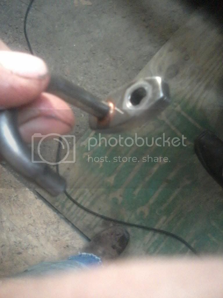

Here's one of my cooling jets, all the others look identical to it. Gonna just leave em as is for now as they seem to be solid.

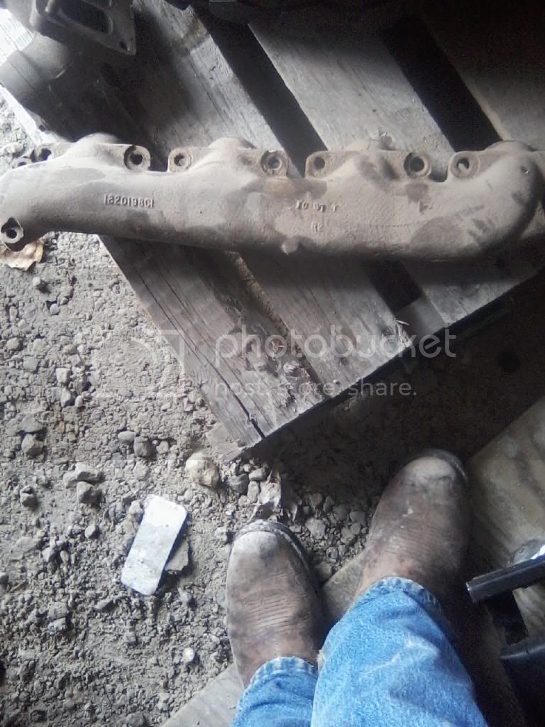

And here's a random pic of a manifold that came with my engine.

The OBS cooling jets are smaller then the SD one's. Not sure when the change was, but I noticed the same thing. I installed RiffRaff's welded jets and thought something was up. So we looked at the three OBS blocks I have and they were the same, the SD block was the larger ones.
