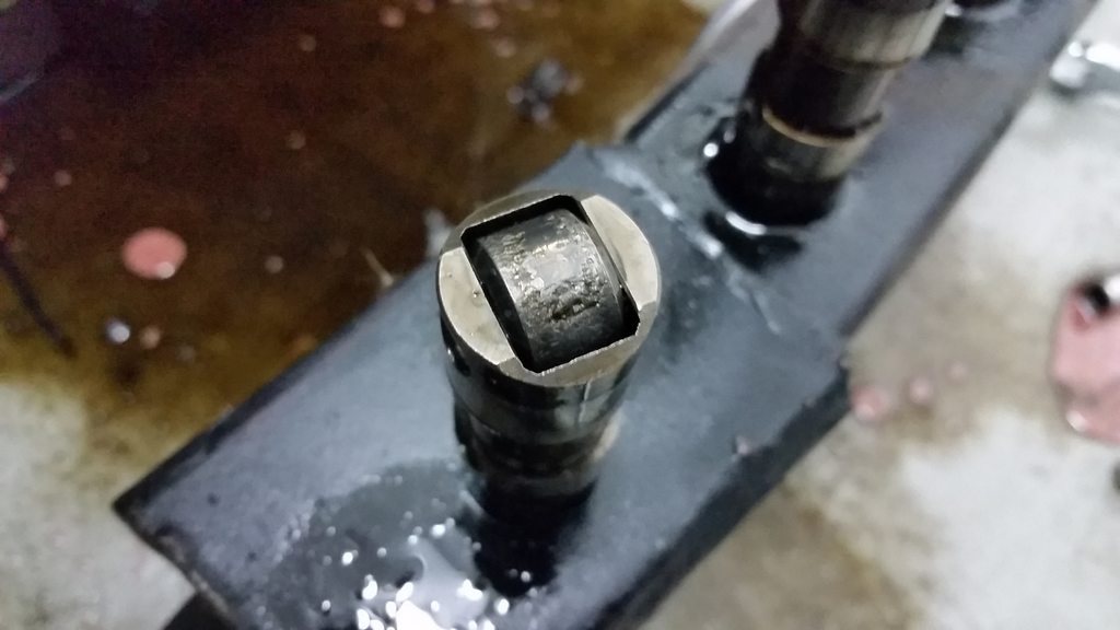

if you think you are actually hearing a lifter, I would not start that engine again. your literally a few thousand RPMs away from letting all the needle bearings loose.
this guy was just barely making a noise. it was actually only heard while parked against a wall. was very hard to distinguish it out
It amazes me that the cam can look like that yet the truck will still run near perfect.
The customer noticed it when he took his truck through the car wash. Called me and I told him to bring it right over. I had a stethoscope on it for 30 mins and told him I didn't hear anything at all... Varying rpm, killing injectors, etc... Nothing. I pulled drain plug and cut open oil filter and told him his Cam was thrashed. 2 weeks later I bought it
