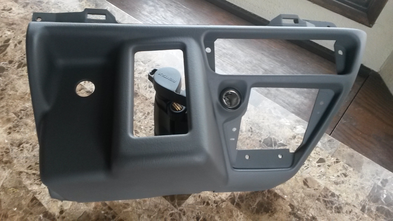

My price from International was 1/2 of the local Ford dealer. Napa made a paint match spray can for $17. This mod was under a $100 for me. Here's some pics of what I ordered....it sounds like it's exactly what you're after. I'm a Zillion percent happy with it.

So I take it color is simply not something that happens then? lol What color do they come?
And lastly..... is there a number on your paint can I can use? You have the same gray dash I have.

That picture is straight from the box...that's the color it came in out of the box. My interior is light blue..
I thought they might. Hence my not understanding the whole send us your cupholder deal...
Sweet, so I'm good to go.
Thanks.
What about fitup? I had a buddy tell me they ordered a couple and they were gappy and didn't fit up well for some reason? Which baffled everyone as the 650 has the exact same dash panels right?

Fit up is perfect. Looks like factory. And yep...it came out of the box in that gray color as in the pic above. Trailerhauler put me on to a Orscheln shifter...looks perfect. I did have modify the north/south dimension on the rectangle shaped hole on the dash about .175" to accommodate the shifter.
