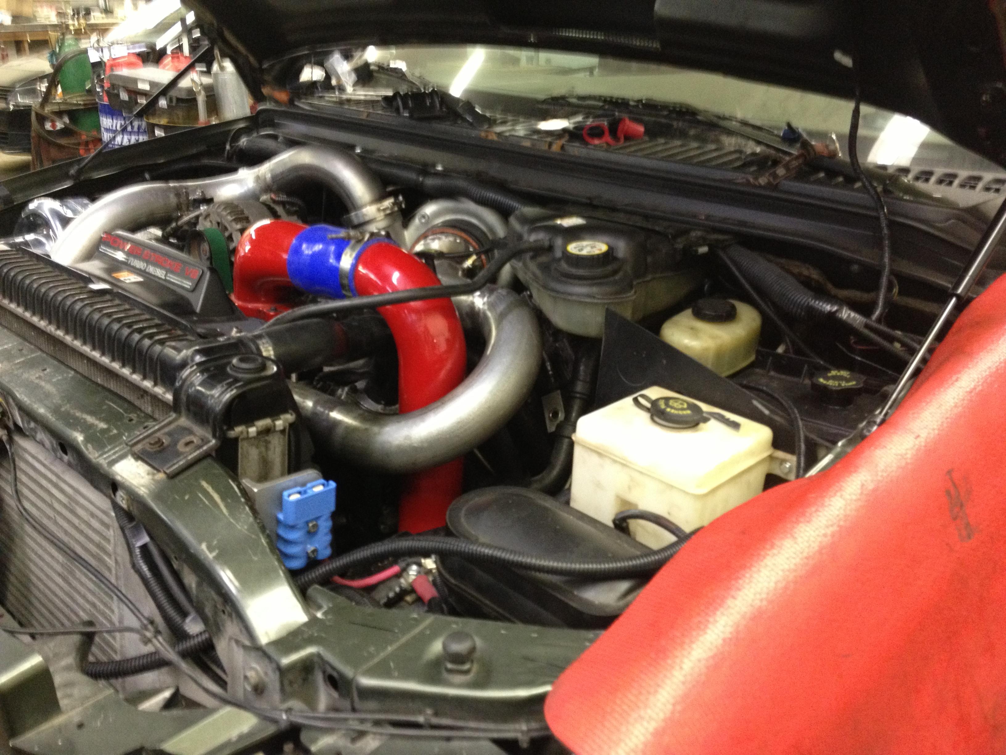

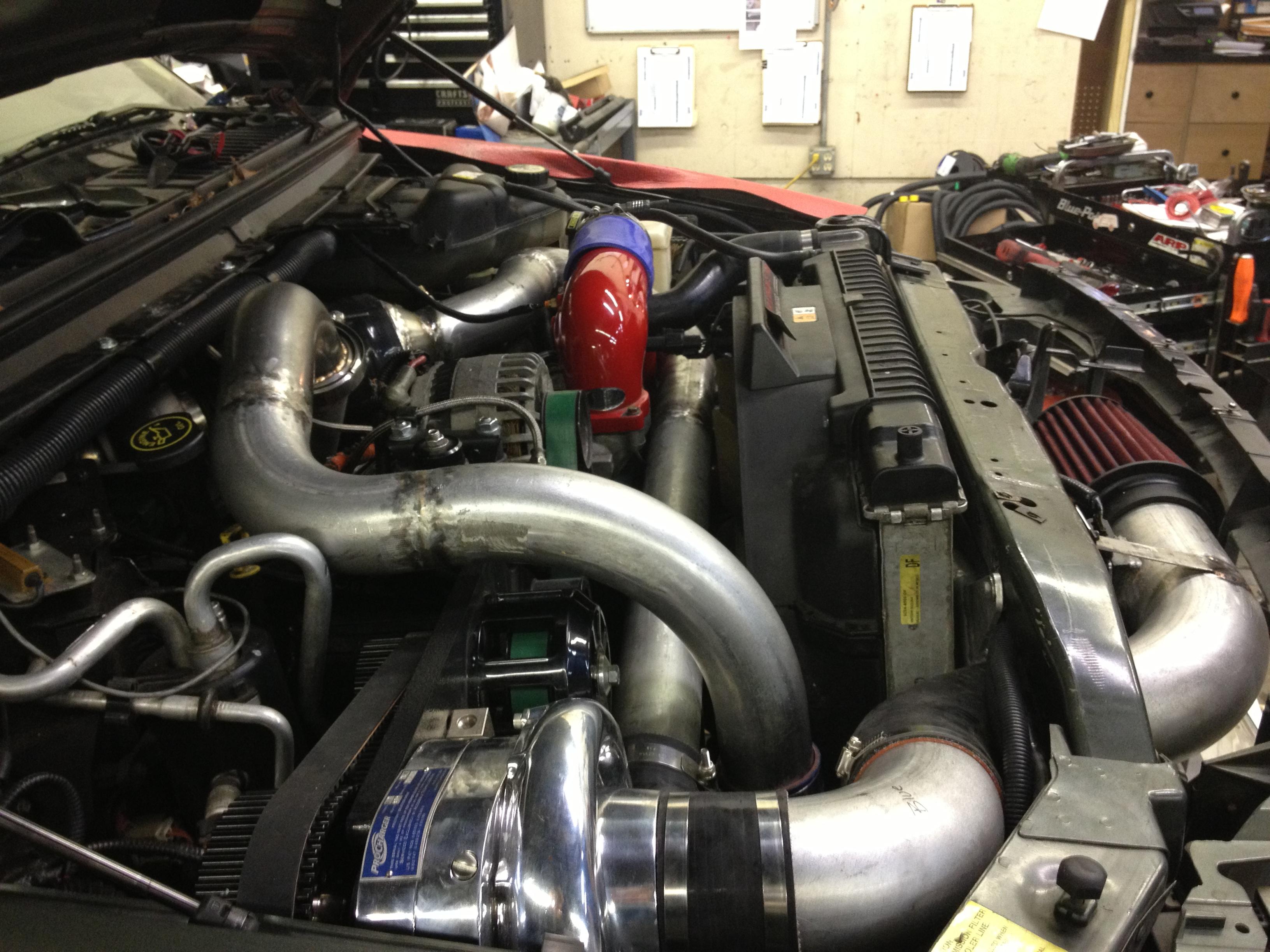

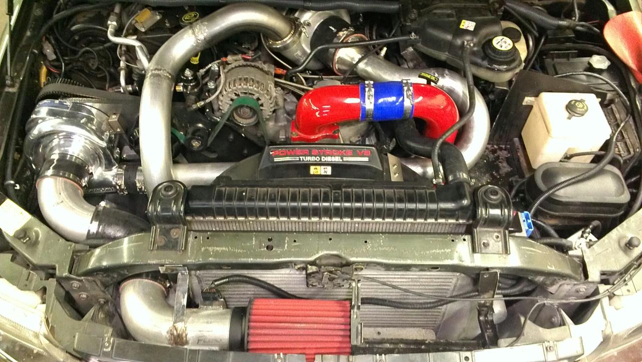

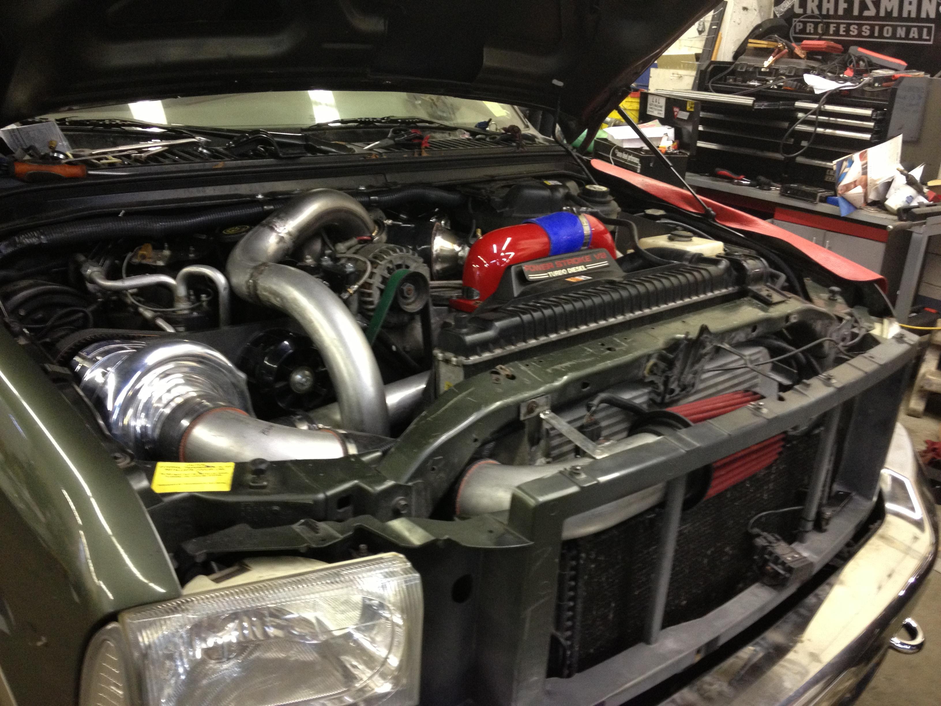

A few pics before the powdercoater does his magic. Should have it all put back together this weekend.

Buttoning up a few things today. First test drive will be tomorrow,should be two gopros along for the ride.

Just a suggestion. Make sure and put a metal connector of some sort at the boot between the intake elbow and the intercooler pipe. Mine blew off there and put a nice dent in my hood. LOL
HiVoltage
67
Thanks for the tip buddy.

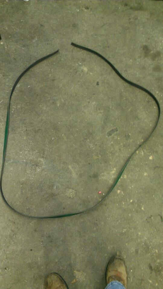

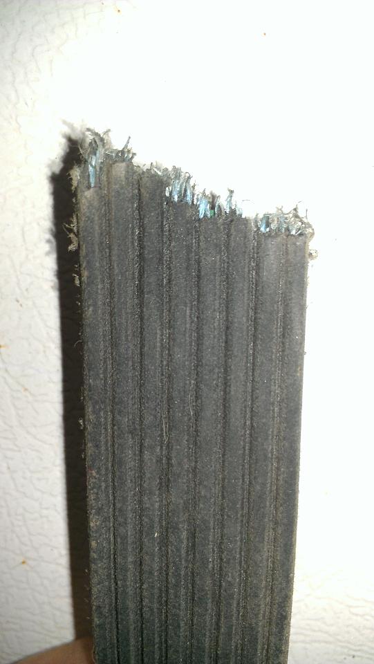

Not exactly sure, best guess is the belt might have been a little tight. Doesn't appear to have any other damage besides it snapping in half.
:shrug:
Any educated guesses are welcome.

Yep, no worries j/k back at ya. Gonna find a belt thats a bit longer and give it another try. They said it sounded sweet when we went ripping back by the shop.Was all warmed up and giving it a half throttle run from 30mph,hit about 45-50 psi, when the belt decided to leave the truck.
