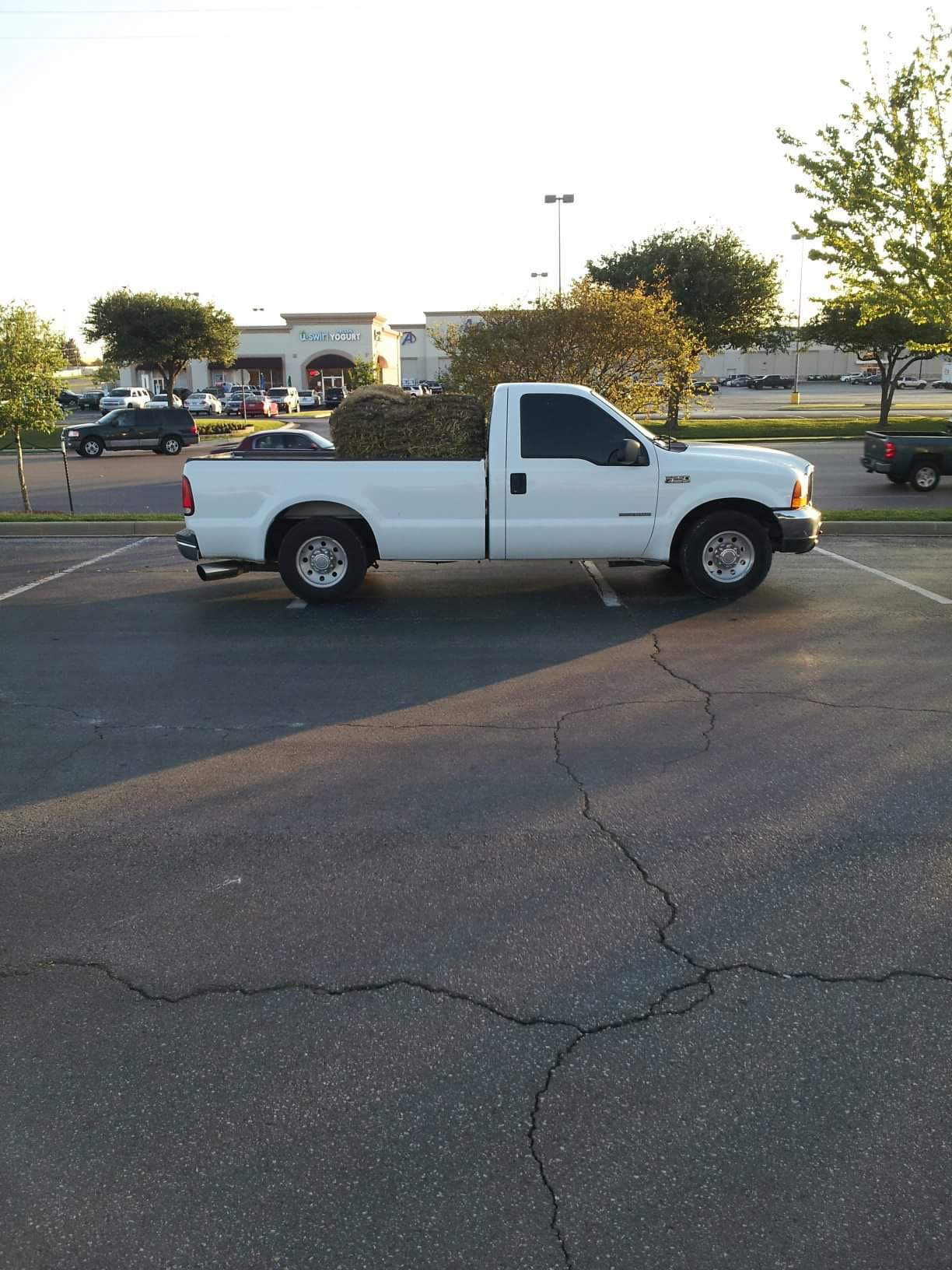

Top one was stock suspension with the top overloads on stock suspension with my '02, grossing 21k, 11k in the trailer, maybe 4klbs before the axles, 6k directly on the axles, and another 1k behind them. I meticulously loaded this to balance it lol. Lot more squat to it than you can see.
The bottom is my 00 with no top overloads, a full pallet of grass, 12 bags of mulch, some trim for flower beds, and a few bags of potting soil. Better dispersed between front and rear axles I know, but it barely laid the spring pack on the bottom overload.
