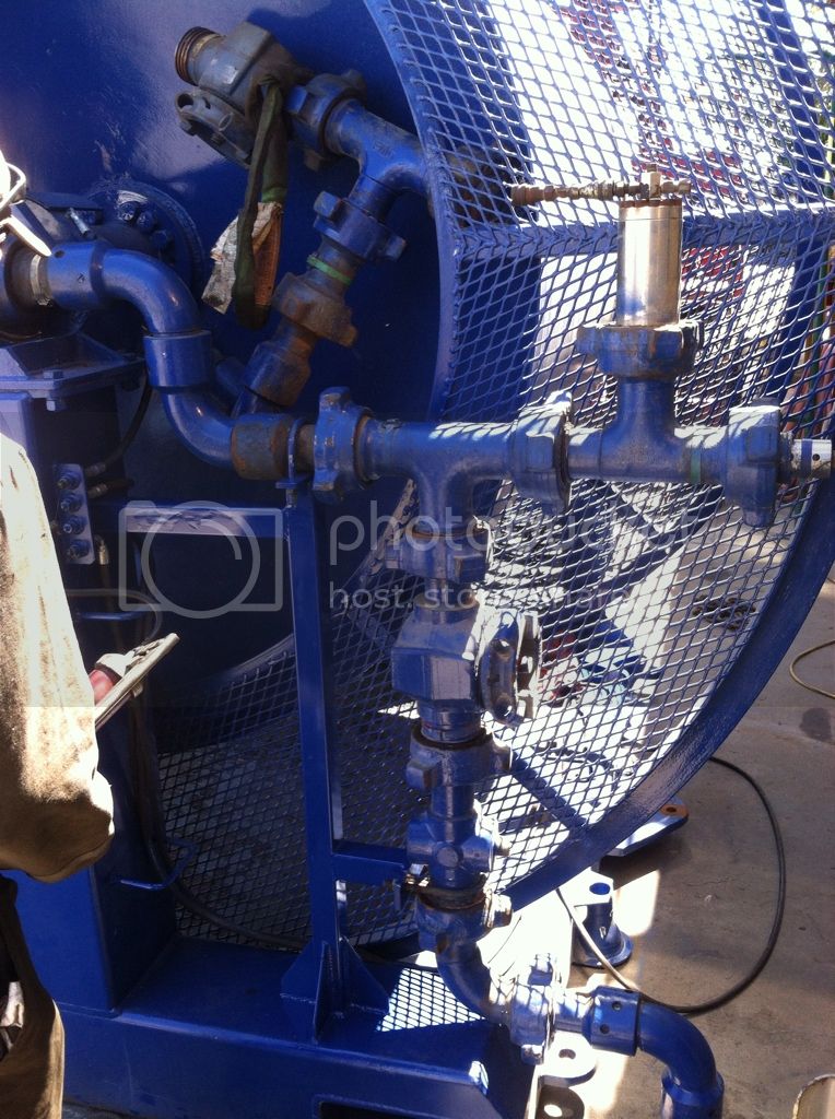

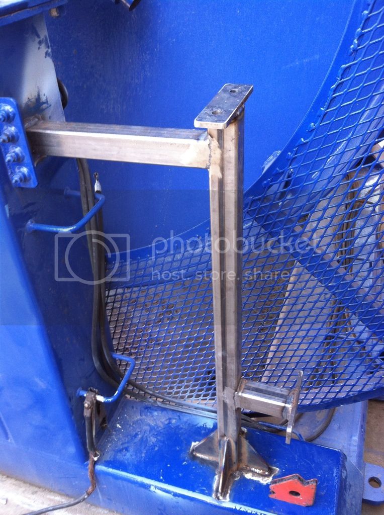

Working on a bran new Great Dane trailer at work. Had to build a new heavy duty bumper for it and ill be mounting a Barco crane on it as well. Here's a pic I grabbed today ill get more of the finished bumper tmrw.
Just a gusset/support and me trying to lay some dime with our Lincoln mig.

Running randor er70s6 .035 using 75/25 mix for the gas.
I finally got my boss to buy a new lead and gun and everything for it and its much better before I could hardly weld a bead 2" long without it popping and sputtering and ****.

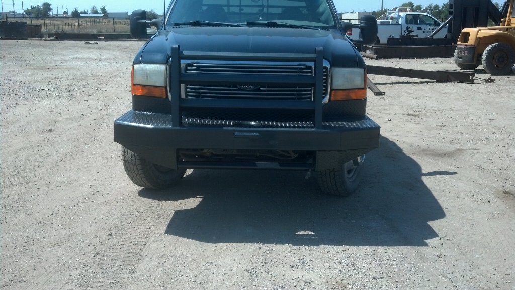

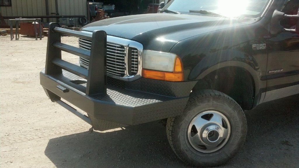

Here's my bumper, 3" X 1" on part of the mounts, mostly 3/8" X 6" & 7" plate, all square tube is 1/4" wall, deck is 1/8" tread plate, and There is a little 16 ga. for trim, and 14- 1/2" X 2" grade 8 bolts. Welders used were a millermatic 265 MIG, and a Delta arc power source, can't remember the feeder on that one. .035 wire with 92/ 8 gas. feed set around 28V/ 395.
