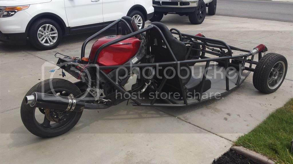

That headache rack and those bed rails are awesome!
I'm converting a bullet bike over to a reverse trike
warped^^ now that looks pretty sweet. Good job. Are they tapered or flat?
Would have to only weld sections at a time not continuous beads in order to keep them from warping right? They look really nice though!warped

oh they look great.. could have tack welded some thicker bar stock across the plate to keep it from warping though.. knock the bars off after its cooled and grind the tacks off...Would have to only weld sections at a time not continuous beads in order to keep them from warping right? They look really nice though!

thats blasphemy coming from a certified welder.... maybe it's just me but i couldn't bare it if i ran a solid bead of tacks across it...Or just used multiple tacks, instead of a continuous bead.

you said tacks.. not stitch.. lol.. but it looks like he did stitch it if you look close you can see start and stops..Not a solid bead of tacks. Stitch weld it.
i wasn't either.. looks greatAaahhh, I'm not going to beat him up over it, lol.
There are heat marks on the top plate, and it doesn't take much to warp 1/2" plate.
Its a nice piece, for sure.
