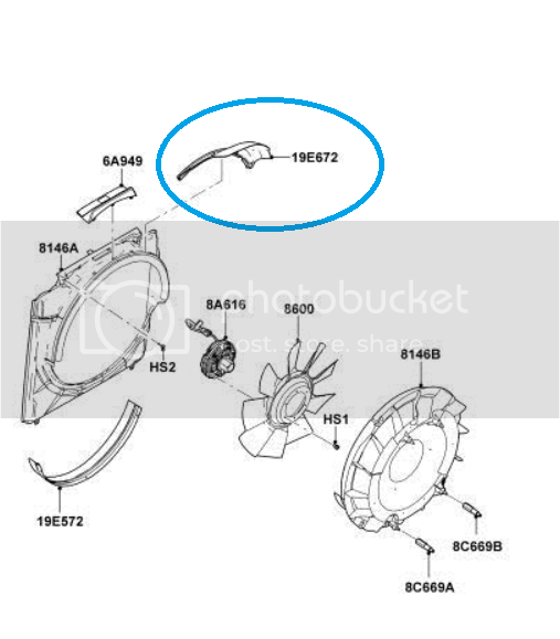

Ya I am only contemplating removing it bc I broke it and don't want to pony up $320 bucks for a piece of plastic that seems to me to be there just for safety reasons. If I didn't bust it I wouldn't worry about removing it.
EDIT: I just looked up the parts catalog on Fords website and looks like the part I busted is No. 19E672 and can be replaced by itself. I didn't spend a lot of time looking at it - just figured it was attached to the stator as it is behind the rest of the shroud.
