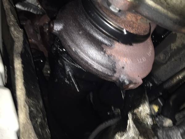

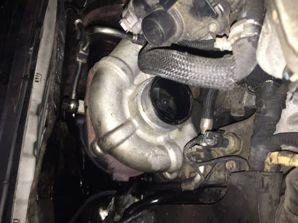

not familiar with turbo drain? so i pulled the intake and no shaft play left to right or in and out. spins fine. I removed the heat shield so you can see where it appears to be originating. check out the pictures and let me know what you think...I dont know why they uploaded sideways...really appreciate the response...

Yes. It is in the center section of the turbo. It looks like that is your problem to me also, use caution running it like that, if the oil comes through the compressor side the engine will run away on its own oil. Turbos have came down a lot for these trucks, with 200k on them I would replace both.

I only ran it for maybe 15 minutes at idel total after I heard the problem trying to detect leak orgin. So fully replacing both turbos is my best bet? :axe: so when you say center section are you talking about the center between the two trubos or the inside center of the low pressure?

PowerstrokeArmy is awesome for those that do not already know. I took the down pipe loose and full of oil probably 3/8" thick sludge. I also heard from a tech I talked to today to check the intercooler and make sure it was not holding a lot of oil. It was not just a drop or two FYI. So based on all this I am assuming that the low pressure turbo seal is shot even with no play....like most I am trying to keep this on the cheap, I know diesel and cheap do not go together but budgets are what they are. Is a rebuild an option? Should I be doing both turbos or can I get by with just the low pressure....thank you in advance...
