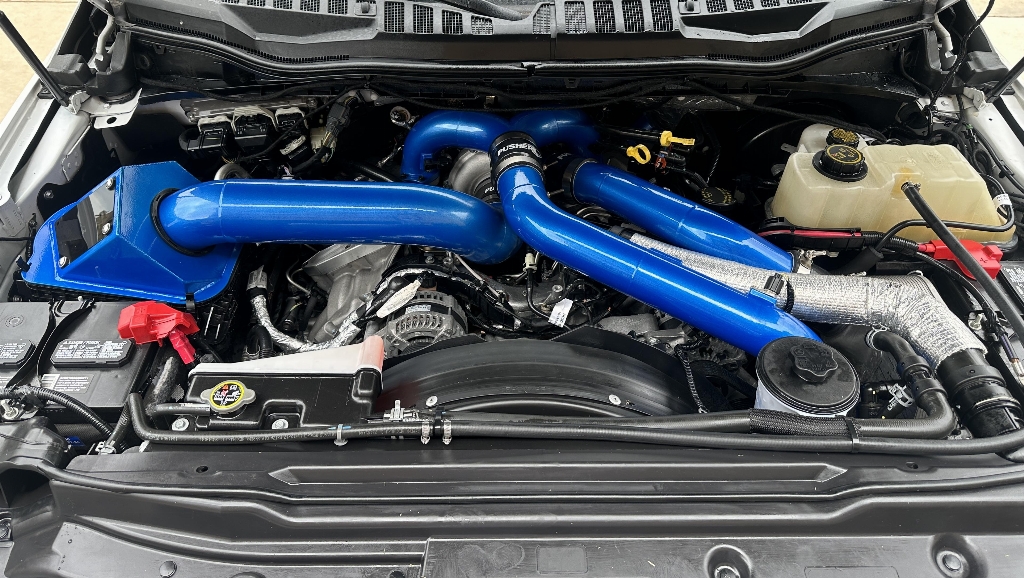

Considering this is 9 years old and I moved to Texas 8 years ago
I also upgraded
I do miss the 6.0 straight pipe and linear boost. The stock 6.7 didn’t have quite the tip-in that the 6.0 has and now with my stage 2 whistler it’s dead until 1500rpm
