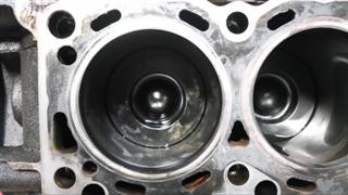

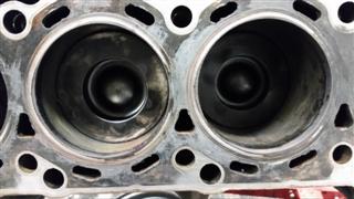

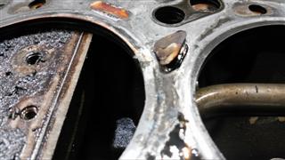

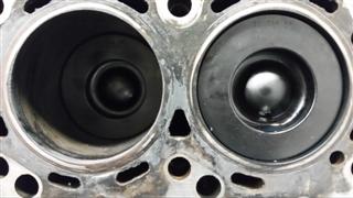

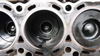

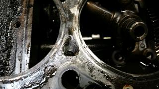

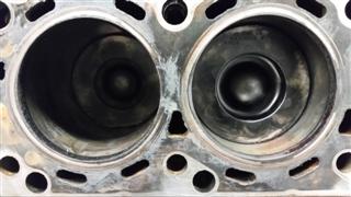

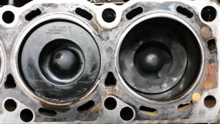

So, upon disassembly... It's amazing the truck was even running! :cursing:
Cylinders 1 & 3
(click to enlarge)
Cylinders 3, 5, & 7
(click to enlarge)
Cylinders 5 & 7
(click to enlarge)
Cylinders 2 & 4
(click to enlarge)
Cylinders 4 & 6
(click to enlarge)
Cylinders 6 & 8
(click to enlarge)
Passenger Side Gasket between 1 & 3
(click to enlarge)
Driver Side Gasket between 6 & 8
(click to enlarge)

When was the last time an 800hp+ PSD build was done where WOT would be for miles at a time, not seconds? I dont think there has been one, has there? This should be cool...
imelmo
6,633
Good point. This will be interesting for sure.
Hotrodtractor
Moderator
4,934
14
Mingo, Ohio
I'm watching - long term high power output has been a subject of discussion around me as of late for various projects..... It can be done I think, but more attention needs to be paid to cooling and lubrication that most do. I'll be interested to see how this manifests itself.
