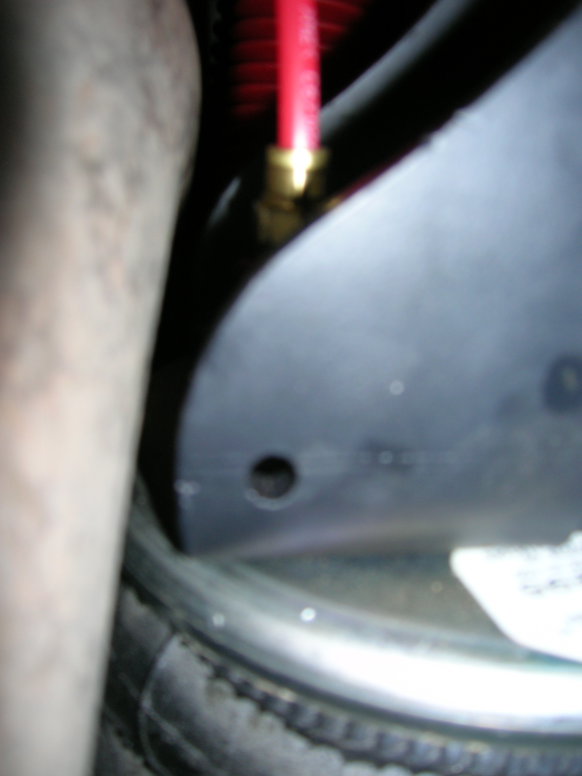

How much clearance did the exhaust have with the passenger side air bag? I have about an inch to my air fitting.
Where is a good spot to get KO 12v power (trigger) for the compressor wiring relay? I was hoping for a spot under the hood on the passenger side.

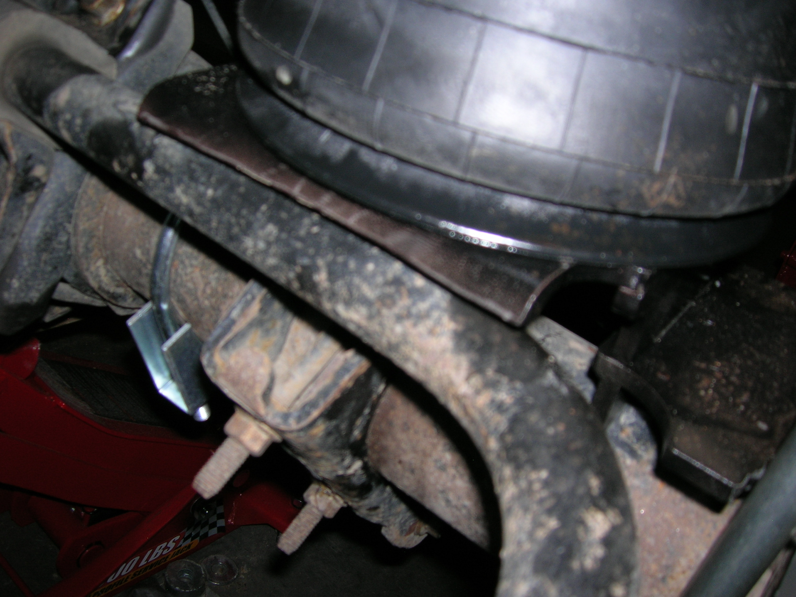

Did any of you encounter lower bag mount interference with the sway bar?
Here is my clearance to from my exhaust to the air bag.
Here is what I was saying about the lower bag mount interference with the sway bar. I painted it black after I cut about an inch of metal of the front of it.
