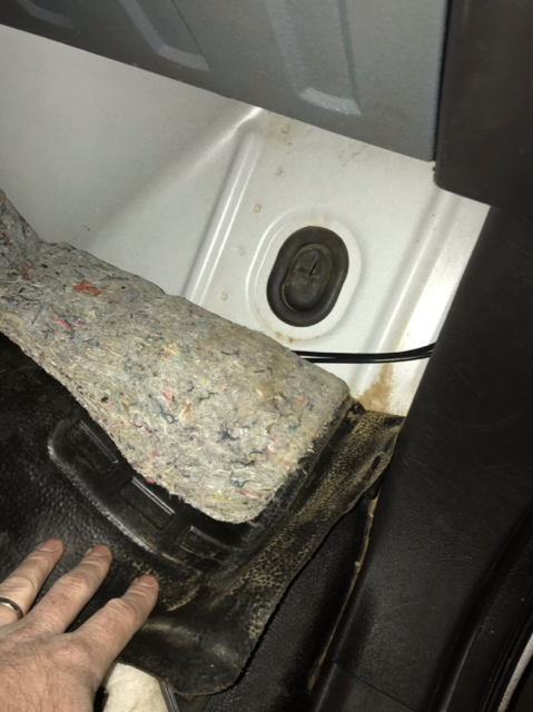

The guy that installed our radios show me a big grommet, passenger side floor board. He said pull the inner fender well and it’s a straight shot to the battery as well. I snap a picture when the truck gets back from getting lettered.
eng53ine
May 31, 2013
849
7
Ohio
Passenger floor board
