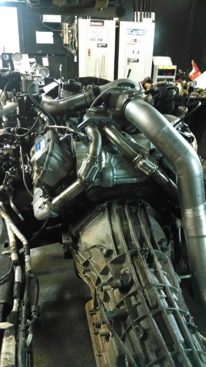

So me, my brother, and my buddy David Farlow (i couldn't have do it without them) got started Saturday morning and started it up Sunday night. Everything went very smooth. Waiting on new air filter and need to reroute ccv before test drive. Will post some videos after I get the filter in.

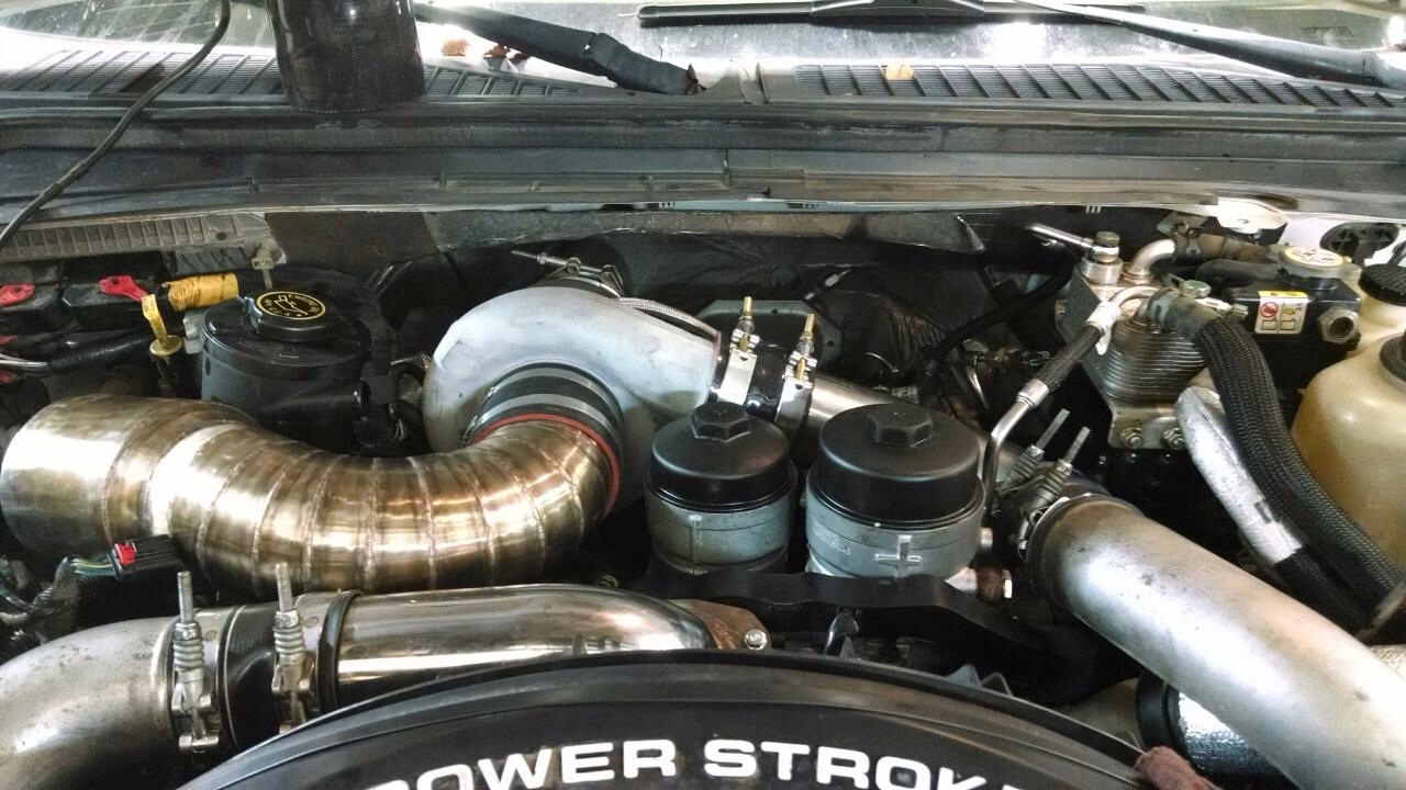

Run's great. I need to get some videos. Prolly put about 500 miles on it since build. Literally the funniest truck I have ever drove. Just bought dual fuelers and going for a custom compound set up with the h&s single. But they wont be installed until after the frame is cut which should be very soon.

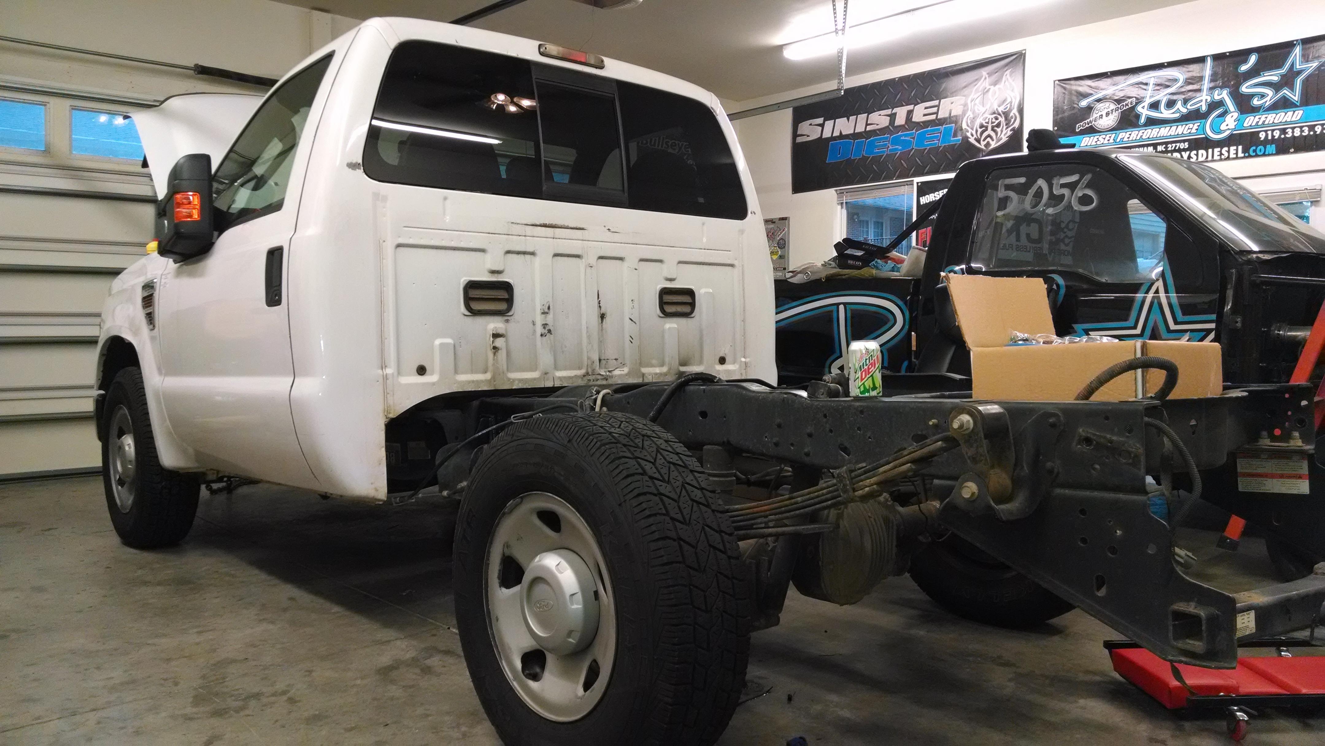

Well its been awhile but finally had some time to work on the truck. Frame is cut, now just have to decide on how much to lower it and what wheels to go with. I already have the DJM 3/5 kit just not sure how it would look. I either wanna use the DJM kit and put 20s on it or just level the rear with the front and put 22's on it. Just wanted to see what you guys thought.

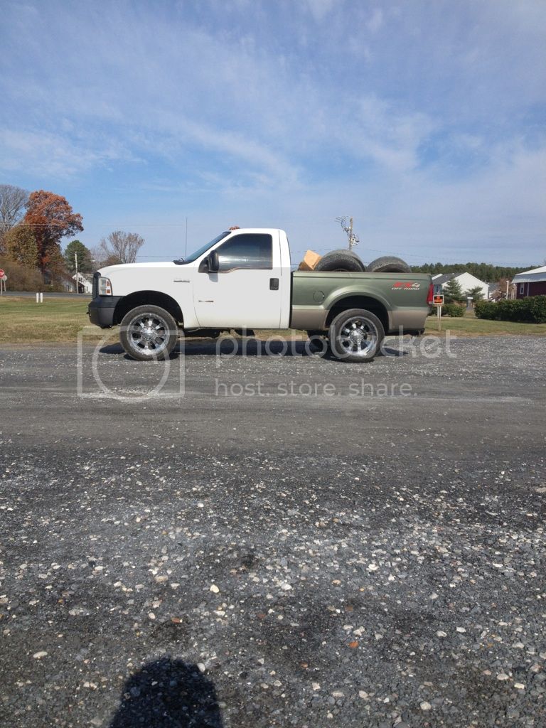

It's about as low as a 4x4 can go, it has a djm shackle flip on the rear on the second setting with no block and 4400lb gasser coils cut 1 coil up front, just a nub for a bump stop lol.
22x10 wheels

I just think with a shorty the lower the better.. But I also used to be into volkswagens and audi's where oil pans were a consumable item because they were so low.

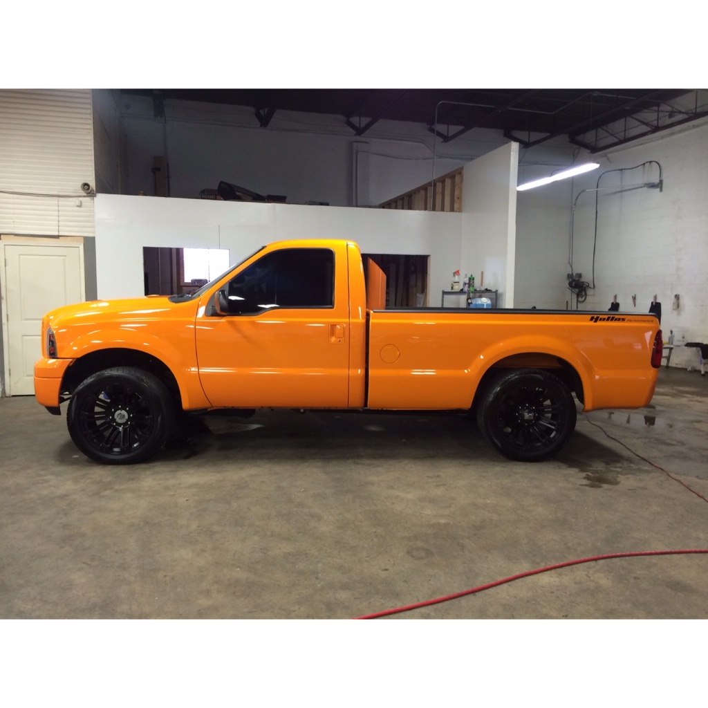

Me to. Always loved shortys. As soon as it gets lowered its going straight to paint shop to get roll pan molded in and paint. Didn't wanna go all out on paint so just gonna have it painted a pearl white then I have a leather swap ready to go in as soon as its done there.
