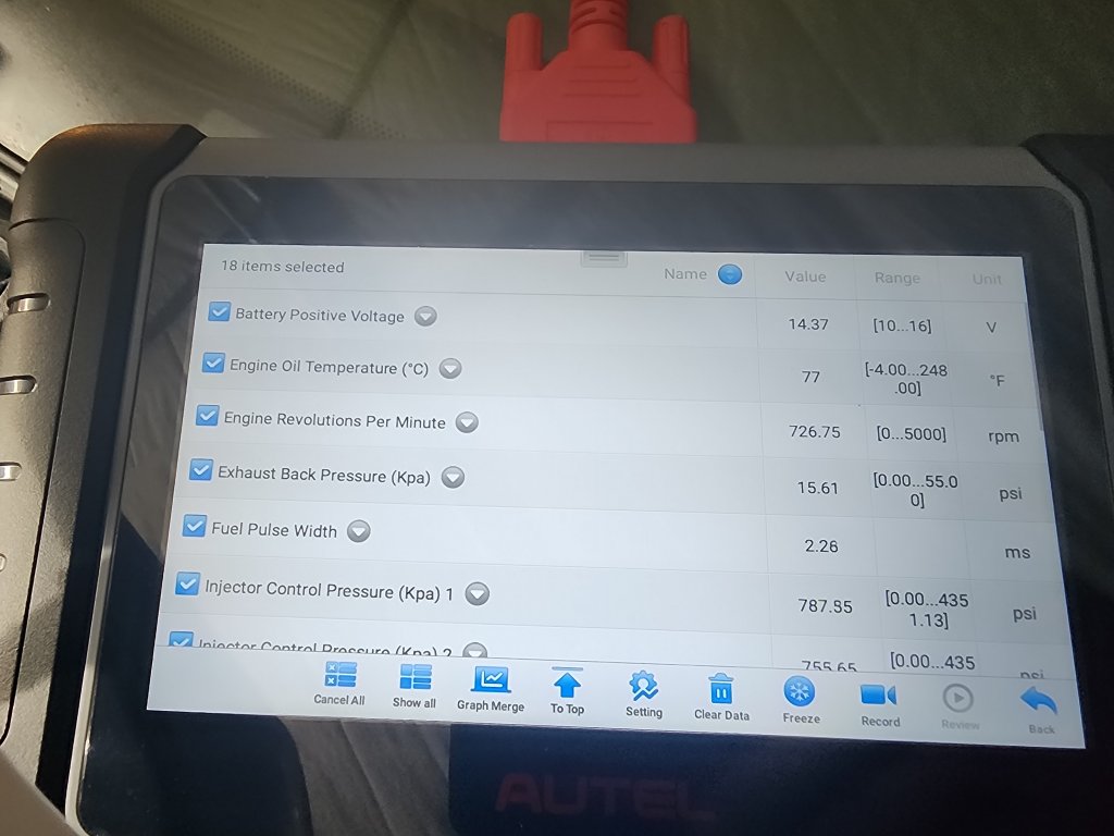

Captains Log - Monday
No Codes in PCM or IDM
Voltage on center pin for both harnesses is 4v-10v (which is in range for the 100+volts)
Audio file recorded but site will not let me attach. Buzz test is clean and clear.
Also attached Autel outputs for the normal sensors.
Additionally, I turned over the motor by tripping the starter to see if I would get bubbles through my pressure relief on my gauge (to check for bad copper seal) - no bubbles
I have exhausted darn near everything. I think it may be time for a compression check. Anyone know if the harbor freight kits works out of the box or will I also need that glow plug adapter?
