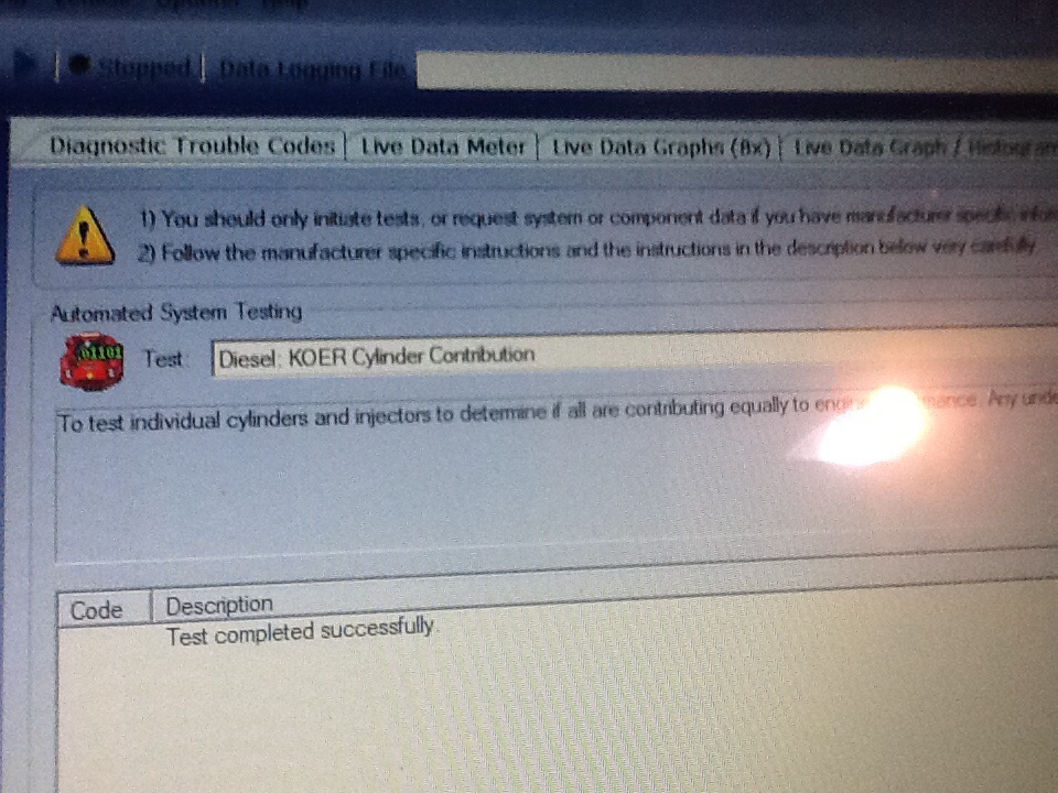

Contribution test

You guys will love it.
Next is getting the fuel right. Maryland is cetane stickered at 40, so some is going to dipping into the 30s.
I use Amzoil's straight cetane booster with point chart on back. You want to get up to around 50 for the engine to run optimally.
I use with it Stanadyne Perfermance Jr. red label to demulsify water from fuel so it will form collectable droplets that can be collected. It also adds much needed lubricity as ULSD is very lacking in that area.
If you use this CPS and get your fuel right, you will be amazed. More power, better fuel economy, glass like idle for those with split shots and smoother for single shots .
You can be heard at the drive thru.
