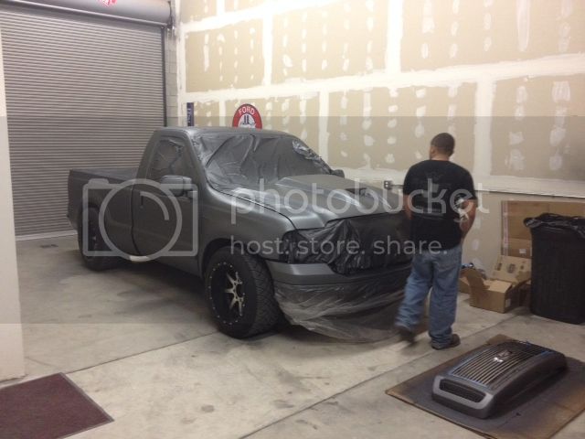

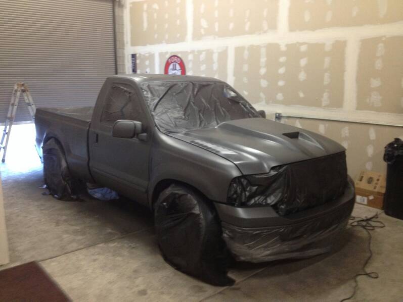

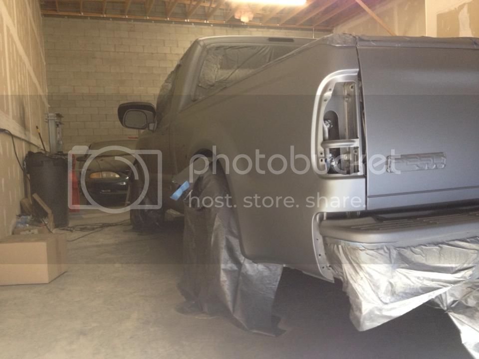

All he got done yesterday was the taping off. He was headed to the shop about an hour ago and was going to start.
Taping and masking, at least to my standards was BEYOND time consuming, but learned and tried a few tricks with weather stripping, that I'm really curious to see how it turns out.......
He paid about $600 for the whole paint kit, paint gun, misc supplies to mask the unpainted parts, and paint. That's less then getting a wrap done.

I was skeptical at first. Looks way different then I had imagined. Nice work Julian!
Thanks man, the pics really don't do it justice
AFAIK he is leaving it as it is. The final coat has pearlizer mixed in
Is he doing the glossifier on this or leaving it matte?
What Sak said.....it ended up being 4 coats of just anthracite to get everything even and one color to get a good base coat. Painting Plasti-dip is very different from painting regular paint, if you want everything to look uniform and even, you have to keep the gun in the same position, no sweeping motions and after you get the 2nd coat down, you have to spray wet, but right before it starts to drip or run.....talk about tricky, but towards the end I was getting it pretty good
Here is the pearlizer I used, which used a ratio of 1 to 3 pealizer/anthracite and then the last 2 was a HEAVY 50/50 mix, meaning I could generally cover the truck with 1 liter of paint, the last two coats took 2 liters each coat

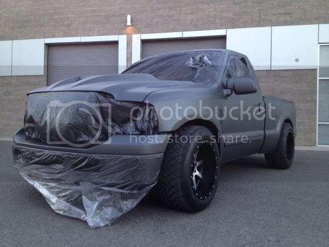

I'm not really sure what to call the color just yet, as I haven't seen it in the daylight, but here it is dry.....

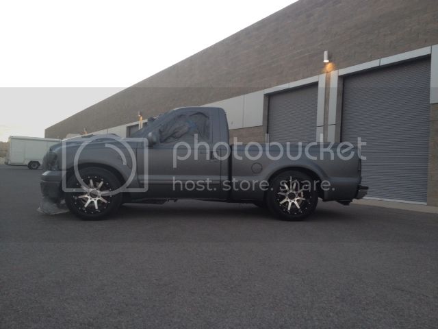

I couldn't wait any longer after an hour, so I had to let some sunlight in....

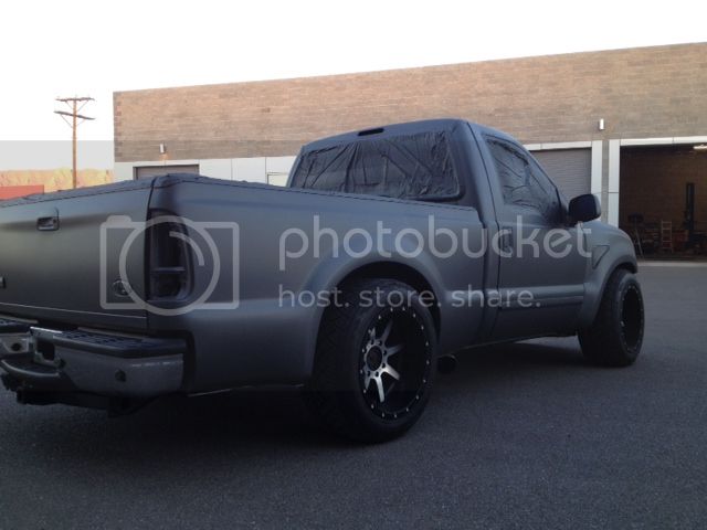

And then finally, I pulled it out, trying to catch the last bit of sunlight that was left....
