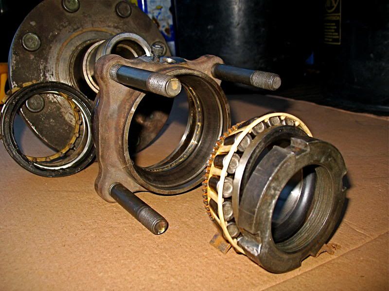

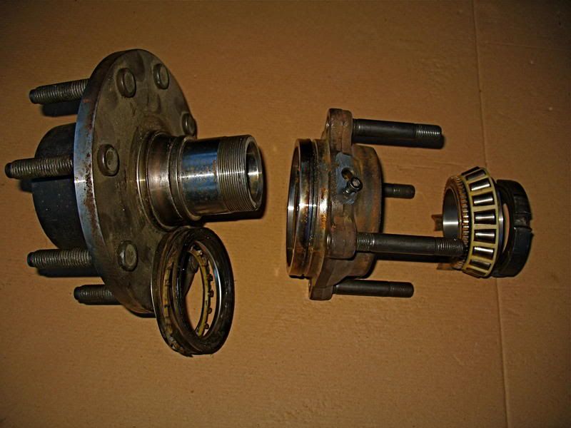

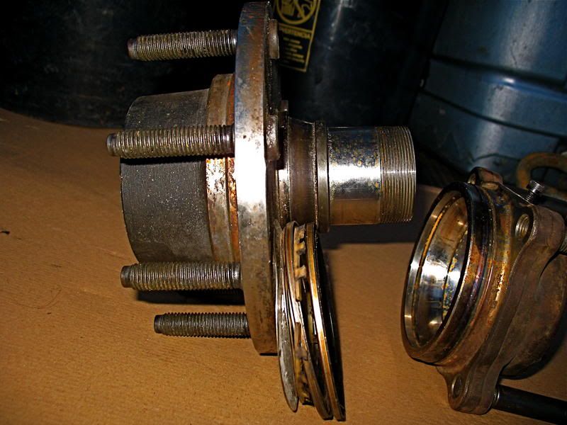

Here are some pic of a blown sealed bearing unassembled: See much grease in those bearings BTW???

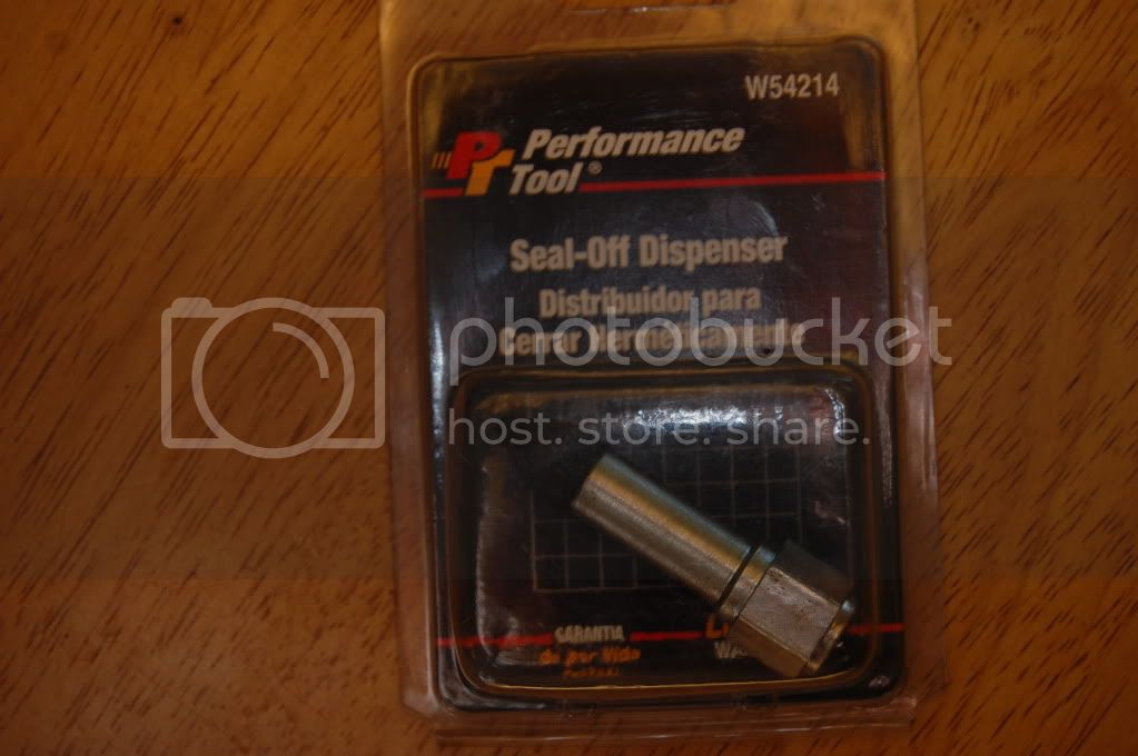

Ok the way to get the grease into that ABS port as standard fitting does not create a seal is to either wrap it with tape to make a fitting fit somewhat snug or to try different tips.
This one was found at Advanced auto parts and should do the trick well. Some people had some machined specifically for this port. You could always drill and tap a hole into the unit bearing in the line as the ABS port then thread a zerk fitting into it and do as normal Just be very careful to not allow metal shaving into the whole. Think magnet vacuum and upside down or at least not straight up. Just an idea.
Here is a pic of that fitting from Advanced:

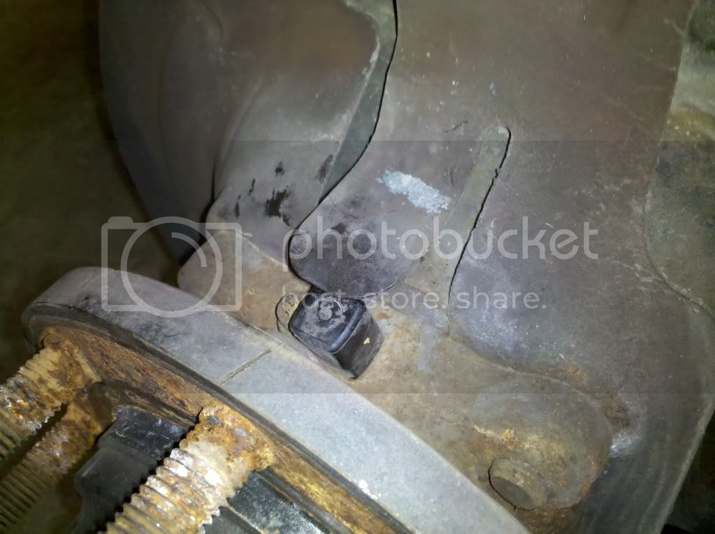

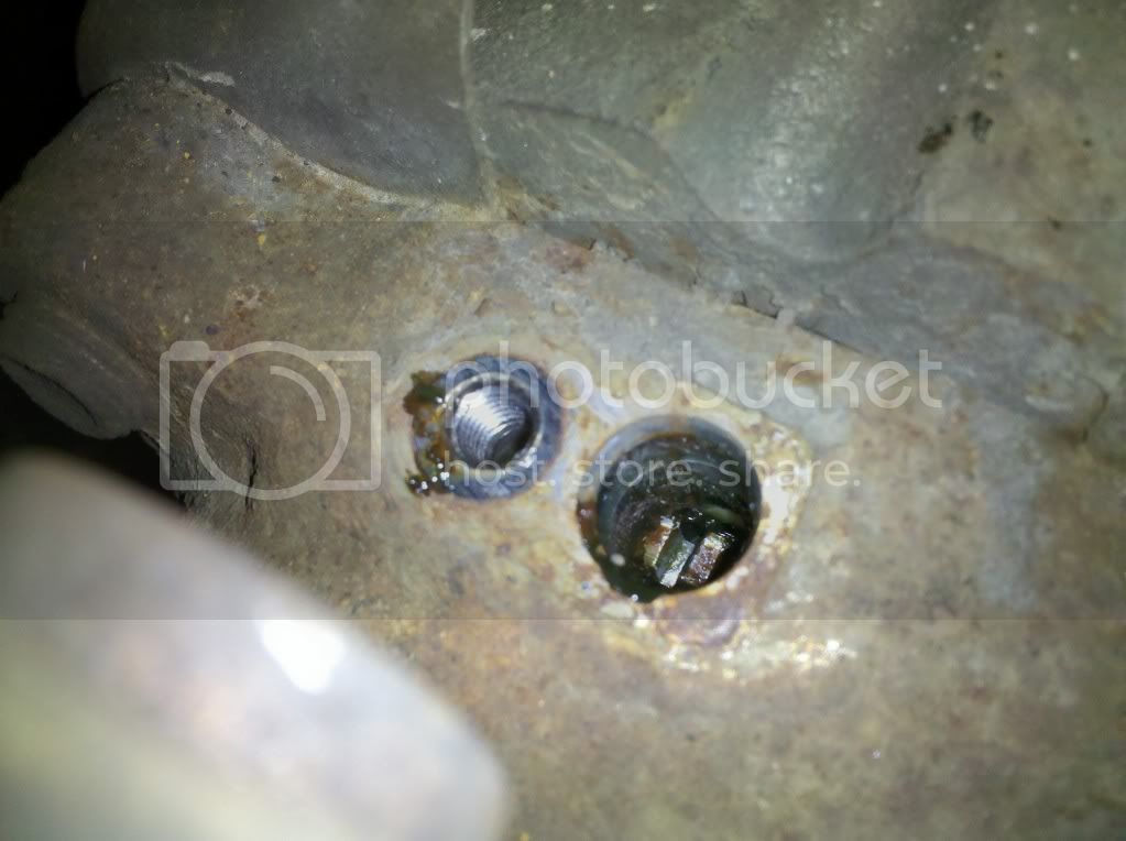

Here is the hole you are going to be greasing into the ABS Sensor port: ( and no its nonmetallic so it does not have any effect on the sensor or its readings.)
Here is where the line is going to the ABS sensor port as you can see the retaining clip on the knuckle. You can also see the vacuum port on the knuckle there.
You must remove the wheel and caliper mounting bracket to access the sensor port. Very easy and well worth it.
sizeimage.php
Here are some shots of the process using the custom fitting. But you should get the idea of how you can make something fit and work.
