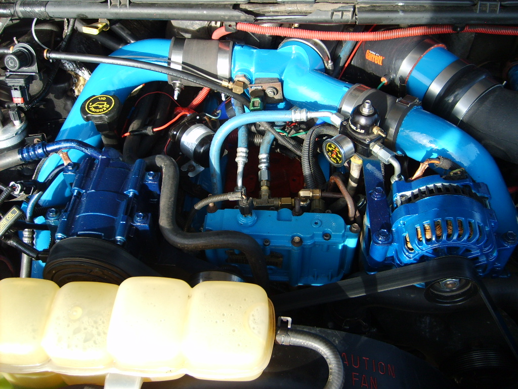

Well the Strictly diesel kit I have looks awesome and has performed flawlessly for going on 6 years now. AND IT LOOKS AWESOME under the hood:D
760
Dalton,NH (The White Mountains)

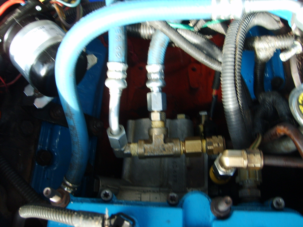

cheap,fast,easy and dont look too bad...i have the old ITP block with SS lines going in when the motor gets put together..

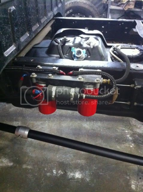

I have the old ITP bowl delete RR as well and couldnt ask for a higher quality kit. Dennis hands down has the best fuel setups. I built a pre and post pump filter setup to go along with the bowl delete out of 2 of his pre pump kits to maintain good filtration.

you only need the pre pump filter, if you do the hutch or add a sump, or similar mod to the pick up area.
if you bowl delete, you need post filters.
if your a diy kinda guy, this should get you taken care of. http://powerstrokenation.com/forums/showthread.php?t=63784&highlight=diy+reg+return post 16. though you can read through the thread and they discuss the various stages of what you would do to your fuel system, and when.
depending on if and what you get for discounts at various parts stores, i pieced mine together for $297, including the fuelab regulator, steel hydraulic fittings, parker pusklok hose and fittings, baldwin filters and bases.
