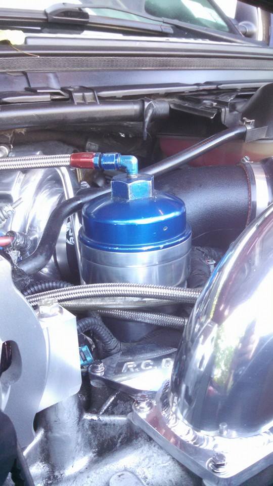

yeah I'd wait to run a better micron filter. If you delete the fuel bowl filter and only run the HFCM filter....the HFCM filter doesn't filter down small enough. I deleted my fuel bowl years ago and the only filters I'm running are the fuel filter and water separator from my FASS. The fuel filter is a 3 micron filter.
